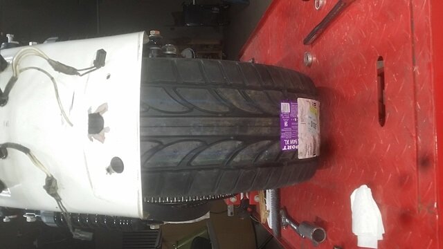

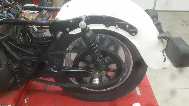

Yes I am running a sidecar. And the Car tire is working great. Heading to TN with it in 13 days. I will have to measure it. Plenty of room with this size the 205/55R16 would have left very little. Even a low tire would have been an issue. Remember if you go this route, stay away from so called rim protector tires, they have a wide sidewall.
It wasn't too hard to do. Couple of shoe horns, a fender stretcher, tubing stretcher, and a little grease.
Seriously, it is not for the feint of heart. Once I had the frame tubing marked, I looked at it for several hours before actually cutting it. I used a modified 2009 rear frame, swing arm, axle, and fender. Made a couple of rear wheel axle spacers to align the rim/tire in the frame. Had to get a 24 mm belt and do a little clearancing on the frame welds. Added a pulley and a disc spacer with new wheel/hub for the tire. Made a couple of new welds that weren't overly huge but still got the job done.
View attachment 71570View attachment 71571
Scary but cool I will give you that The 195/60R16 would have been about 1/2 inch narrower .
I knew that would be the widest that I could put on it. Had both of them in the basket and went with the 205. I'm figuring this winter when I do some other stuff, I'll go to the 195. All I can tell you is that it rides and stops like no other. I like it. Took a bit to get used to it though, not going to kid ya.
On the sidecar rig the car tire rear has worked great . I ride in the winter in Wisconsin the difference was amazing. I went with the 195/60 for two reasons . The clearance on width is better should you get a low tire. The 205 was pushing it. And on mine the tire came out prefect on height it was the same so that was a plus. I salute your effort getting that on an 07 frame.
