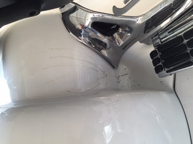

Look at the picture at the bottom and you can see where I have some oil blowing on my right fender on my 06 Wing with a Champion kit. I can’t find the leak anywhere and it seems to come and go. I can go to a 200 mile ride and it won’t leak a bit. I might run up to the corner store and will have marks by the time I get there. It has been going on for over a month. I have pulled both right side panels and they are dry inside. Value Covers are dry. Under the trike is dry. Around the oil filer and oil drain is dry. Not a drop on the ground where it is parked.
Most of time I have on white tennis shoes and have rode with them on the floorboard and on the highway pegs, not a drop on them. Today I rode about 2 miles up to the corner gas station and by the time I got there I had oil marks. Rode about 20 miles to a friend’s house and had more on the fender. I cleaned it off and the trike sit for about 3 hours so it was cold again. Rode about 50 miles coming home and nothing, not one leak, nothing is wet anywhere.
I have rode it slow and sometimes it’s there and sometimes it’s not. I have ran it at higher speed, sometimes it leaves oil marks and other time’s not. I have tried running higher RPM’s, same thing. Sometimes it does it when I first start off and other times it starts after it has been running for a long time. It only happens about 10% of the time but that is 10% too much.

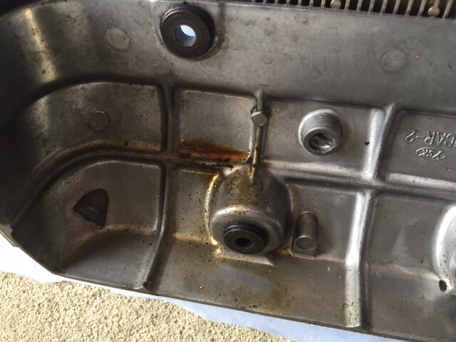

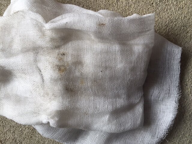

I found something. I went out to see about covering the valve cover with cloth some how and I once again ran a rag all around the outside of the cover, it was dry. I then removed the cover where the plugs are and there it was, OIL. Not much at all but there is some oil on the ledge near the front of the inside of the cover. The rest of the over is dry as can be, the picture shows all the oil. I then took the cloth and wiped all in the area where the plugs are and it came out with just a tiny bit of oil showing. Zoom in on that white cloth and look how clean it looks. So now that I found A LEAK, is this something that I may be able to fix or does it need to go in a shop?
I should say I took off the cover for the spark plugs not the valve cover.
Could be that the rubber part of your valve cover needs to be replaced...that is the part where your bolt goes thru...only other thing from your pic, would be a cracked valve cover.
I don't think there should be any oil in this cover that has oil showing. It is the cover that would be removed to replace the spark plugs. I'm thinking the valve cover gasket it's self is leaking into this area.
