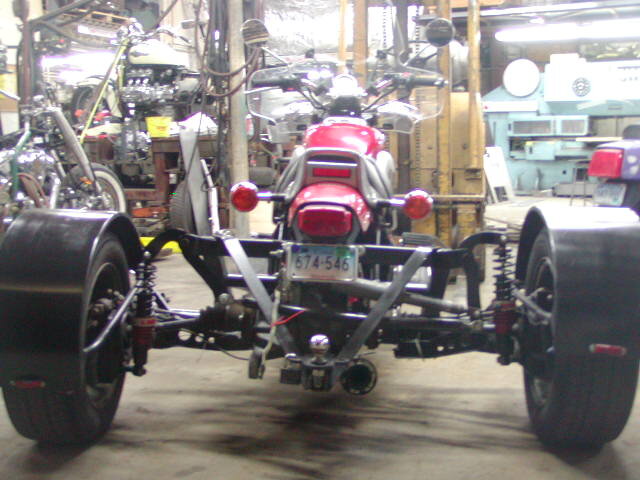

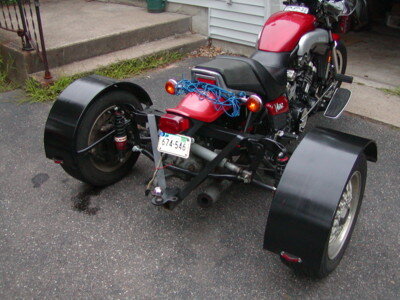

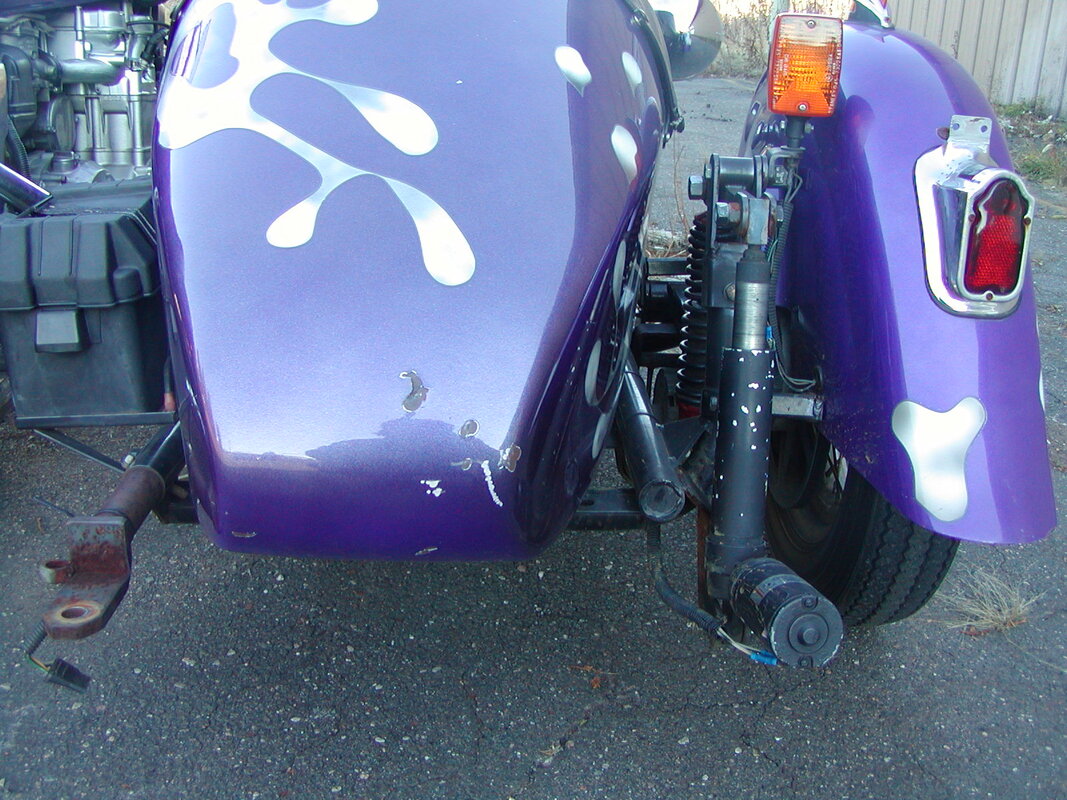

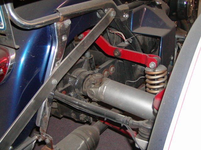

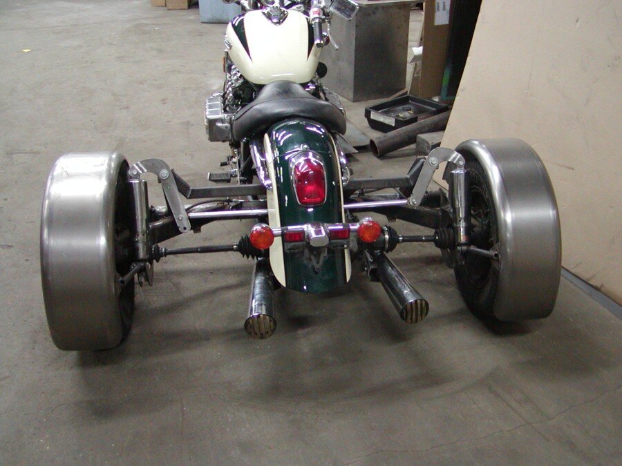

the crown absolutely affects how a trike handles there are those who say i am nuts but have been called worse.... back roads generally have a bit more crown, which is mostly built in not "worn in" but on those long stretches of high way it tends to wear on the arms...and the more trail you have the worse that pull gets... i like about 2" trail which is pretty easy to steer but hate those long stretches and if you get set up to ride the right side of the highway then travel in the left for a while it will go to left ditch worse than it wanted to go right before... sidecars have the same problem and sidecar people have had screw jacks on the sidecar to compensate that for yrs.... after i build my 1st trike that wasnt a hardtail... every one has an electric lean.... i can pretty much steer with the switch on the highway... basically you are leaning the front wheel so it pulls to that side.... best time an $ spent on suspension for anyone who ride a lot... didnt mention if you have a straight axle or independent... if it is irs you can lift the right side a bit.... it wont take much.... if it i straight ... keep in mind if you raise one side you are misaligning the belt,, not sure but seems it would wear the beltP1010013.JPGsp1s.jpg2.JPGP1010029.JPGHDDIFF2.jpg
