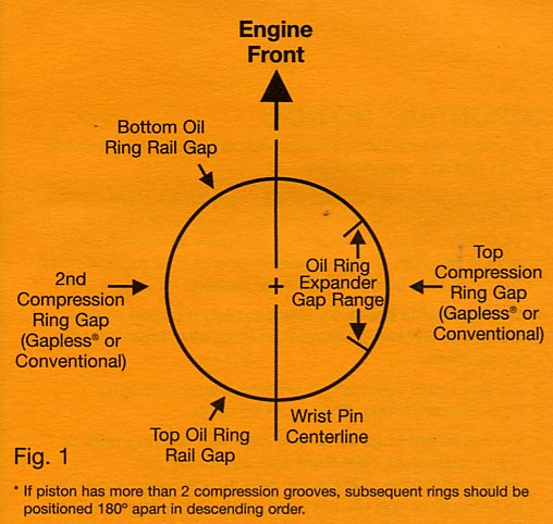

Trikenewby here. Just thought I would let you guys know what I found when I tore down the dyna evo I am working on for a friend. Front cylinder top two rings gaps lined up both facing forward. Going to correct that and rebuild cylinder heads. Thanks for your replies.

That will do it, Good find. Kind of the elimentary of rebuilds to stagger them. Ya never know. :clapping:
Good on you !!! :clapping::clapping::clapping:
Did you check the back jug? Odds are if he did it on the front he did it on the rear too. Flood gates were open....I bet that sucker did Smoke !:AGGHH:
You're aware that rings rotate during use. Thats why 2strokes are pinned. I'd b lookin more at the guides or seals
Proper Ring Orientation is Shown Above
Click on the Image for the Full Ring Installation Instructions
