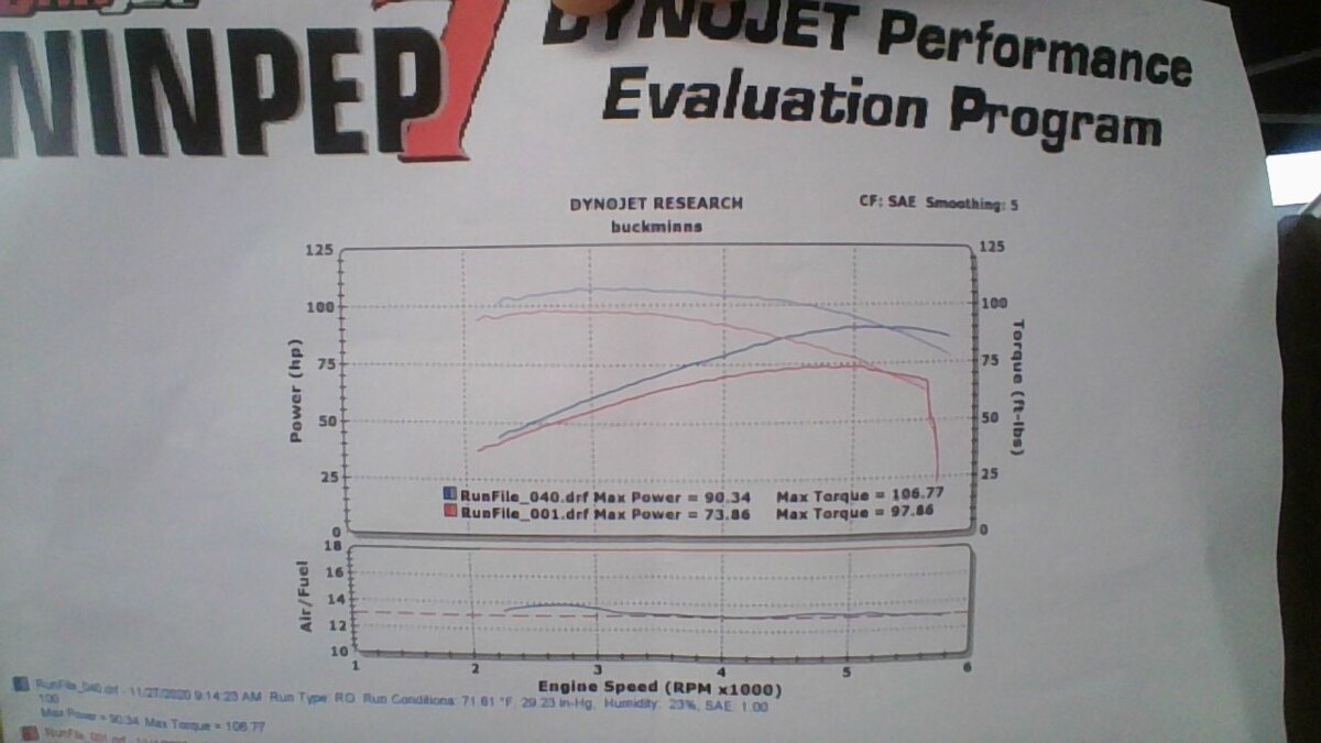

Who is MT anyway. never heard of them
480MT means "Monster Torque", the cam is made by Cycle-Rama. It is the same as their original 480 cam just sooner and holds out longer. It's made for low-mid range torque. If you are chasing numbers, this isn't the cam for you, numbers on mine are just a bump from stock but it will now definitely"stump pull". Twist the wick and it grunts! Tuner is a Power Vision and was done by Those Dyno Guys in Pinellas Park, FL.
