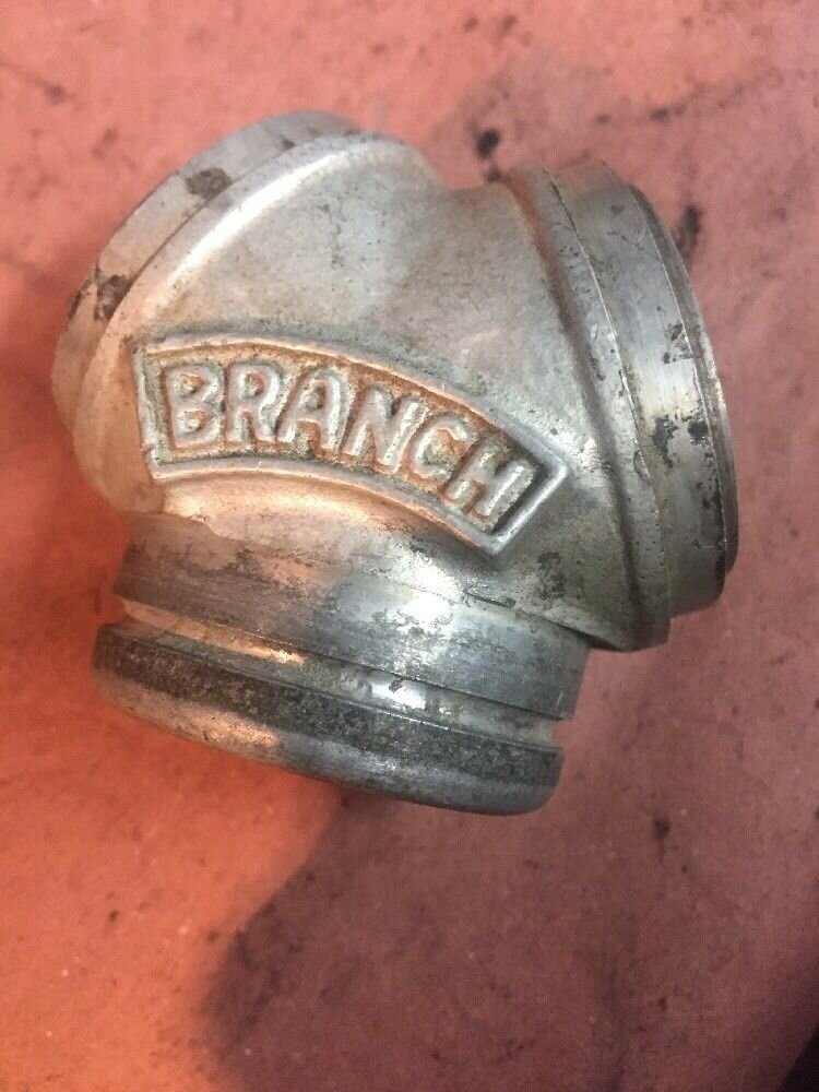

Yep...I had ported and polished Branch heads and manifold on my beater pan-shovel chopper back in the day
Jerry Branch top ends and Truett-Osborne bottom ends.... Ahhhhhh... a simpler time and place (Mmm)

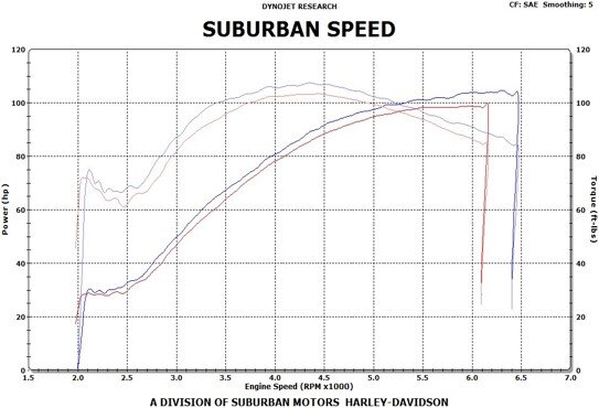

Suburban Harley Davidson dyno tested the new manifold on an M8 (they did not mention displacement)with SE Hi-Flow Injectors to see what they got. Here is what they showed:
The relative HP increase (4-5%) is impressive for just manifold and injector changes.... the "stock" HP seems high vs. others I have seen (maybe it was on a 114? Dunno).
