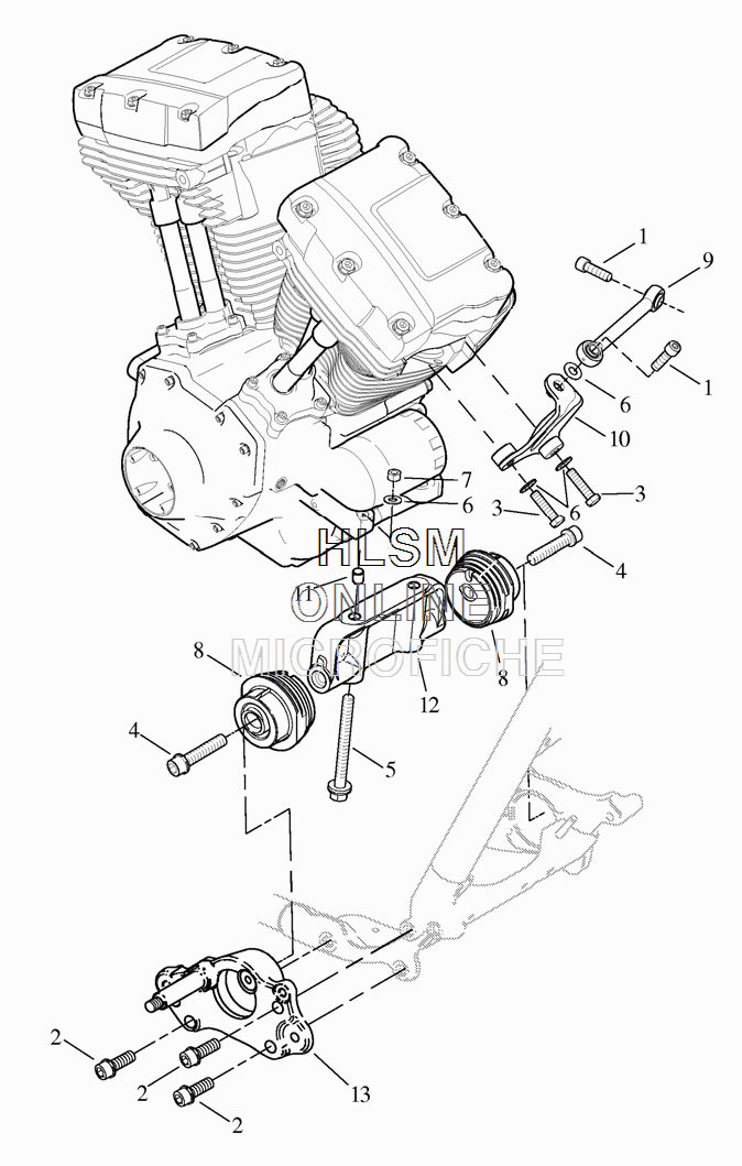

Is it here ??
The velvet link stabilizer will eliminate the bolt failures.
That whole thing is part of the motor mount system. The 2 bolts he is referring to are the ones that bolt the bracket to the front top of the engine that has a stabiliser link to the frame off the top of the bracket. I have run across several bikes/trikes where these bolts are loose, gone. I have heard of them breaking off. My TRI right now has lost one of them. Because of the engine vibration they come loose. The real part that makes just slapping a new bolt in a proble is that there is a round spacer that goes between the bracket and the head which the bolt goes through, that gets lost also. I put lock washers on them and they still came loose.

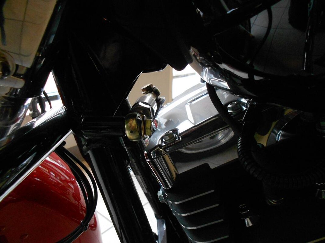

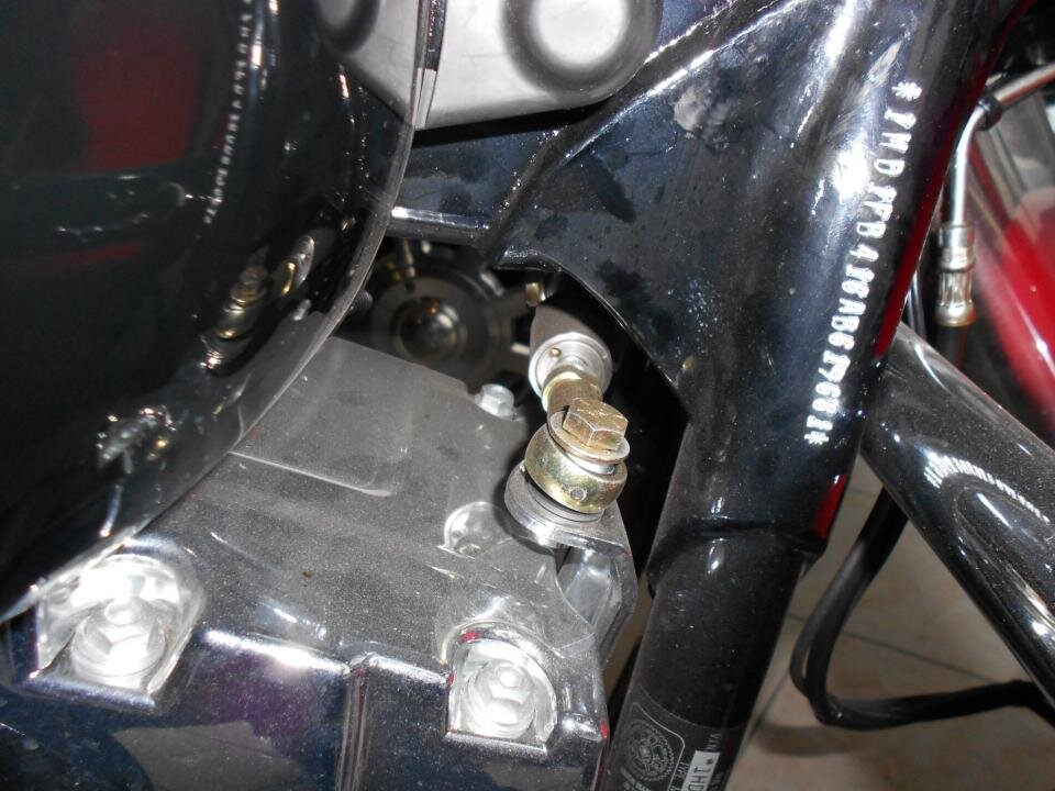

This is the link used for all FLH-FLT-FXR up to 2006 with top engine stabilizer between cylinder heads. It also works for 2007-2012 for the front upper stabilizer link replacement.
I installed those and the upgraded front motor mount on both my FXR & FLHT, for me there was a noticeable difference, and well worth the money.
