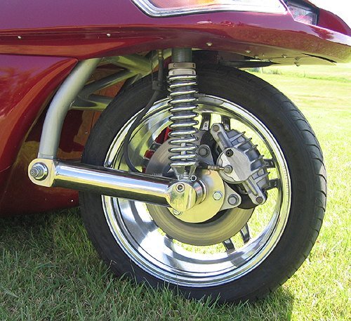

frontsuspension1.jpgThis is a typical LLF. As you can see, the usual meanings of rake and trail do not apply here, IMO.
Rake and trail always apply. Its really caster angle. Just google rake and trail. You need less angle on the frame neck or more angle in the trees. On my bikes I've found anything less than about 2inches makes the steering 2 guick.
