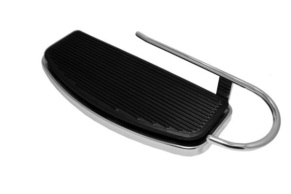

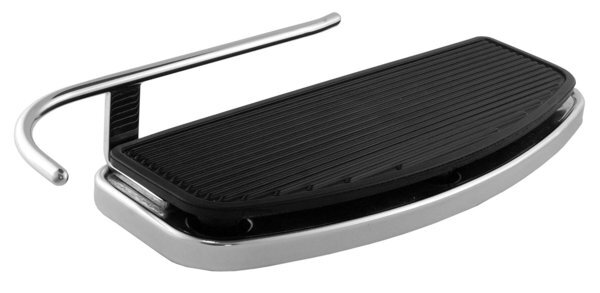

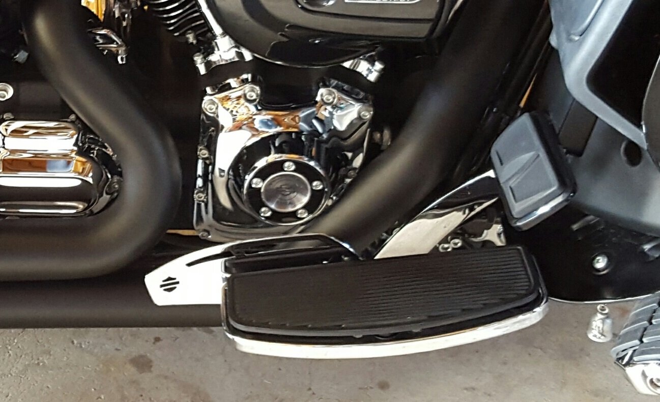

There are quite a few out there - But all about the same price. I liked the HD logo.... Right side only and I did put the Floorboard Extenders {both sides} I haven't had to clean rubber off the pipes since. Looks like the best price is here:
http://www.surdyke.com/AdvPartInfo.asp?PartNumber=50500225

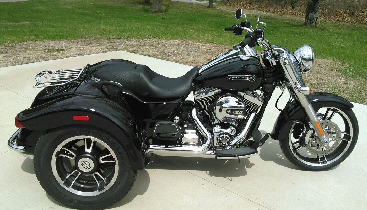

JC1300,
I like your choice.. and that includes the blacked out pipes. What are you running there?
Sorry, not trying to hijack this thread... I think that the guard is the best looking I have seen also.
When I originally bought my Freewheeler (same as Tri-Glide) I bought / installed the H-D floorboard heel guard too, P/N 50500225.
Then I installed DK Custom floorboard 1" extenders P/N DK-TR-FLB-EXT-TG. I didn't need the heel guard (my big feet were further away from the exhaust) but I liked the chrome guard, so I left it on.
However, I subsequently bought / installed H-D 1" longer floorboards P/N 50409-04. Although it's not mentioned on the H-D web site or instruction sheet, I was forced to remove the H-D floorboard heel guard. The two aren't compatible.
My 2¢ . . .
JC1300,
Thanks - Those are the Rush Headers....I am a fan of Rush in general for performance and quality, but really like them because they are ceramic coated inside and out. Drops the heat......my wife appreciates them a lot.
And they are H-pipes but don't look like it!

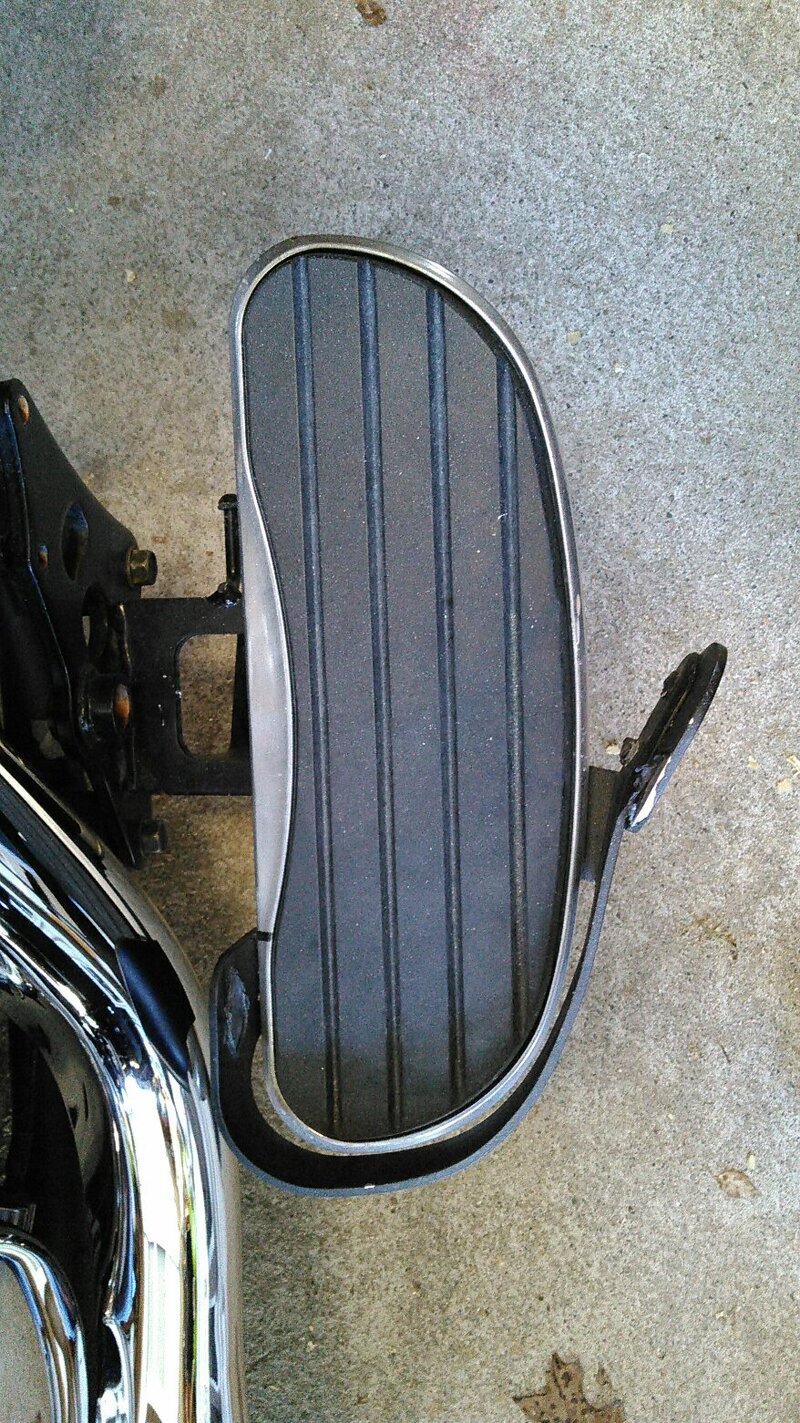

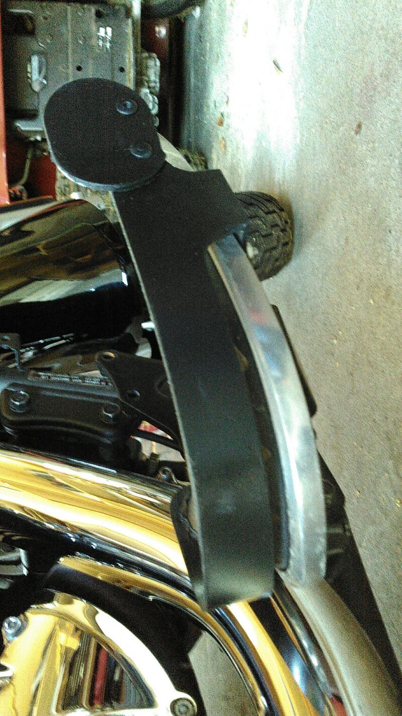

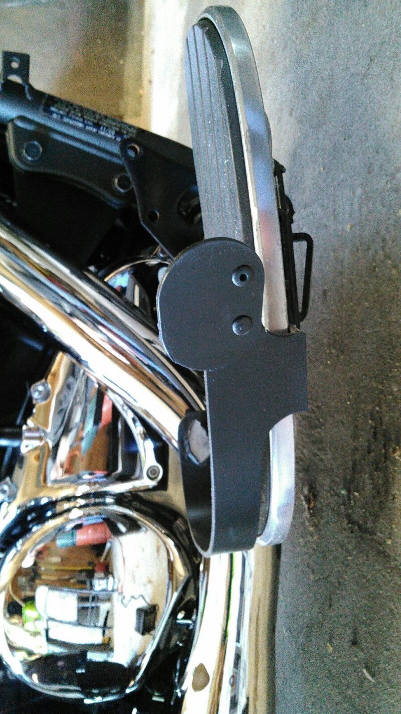

I know this is an older thread, but here is a pic of my new floor"boards" and the Carl Miles heel guard that works great to keep my foot/boots away from the hot pipe.
