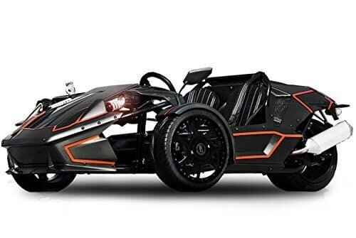

The reason I asked about getting in and out is that the body on the version in the first link you posted had no cut outs on the side for entry/exit as do the ones in the video. I also didn't see enough in the video to make me think this project would be simple even for a bike mechanic (I am a bike mechanic). The one liquid cooled motor had a radiator coming off and to the drivers side behind the cockpit; not sure how this would play with bodywork. Didn't see a gas tank on any of the customer units nor a battery, regulator/rectifier, fuses, etc. Do they provide motor mounts, brackets for an exhaust, etc. A good drawing of the frame showing details would do more good than the video and the video had text over what you would want to look at for much of the thing. There is a 3 wheel like this in the classifieds for a lot less than it sold for new.
This is the first image i posted, looks pretty easy to get in and out of.

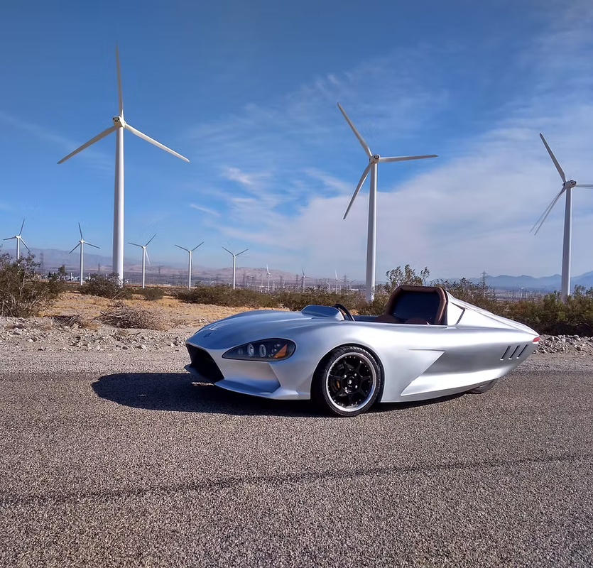

Not sure why that silver bullet is pictured on the title page for their trike they are selling when the actual body is much different. Good luck with your project.
Thanks! I had the same question. They said it is one of their customer's builds with their own custom body panels they made.
