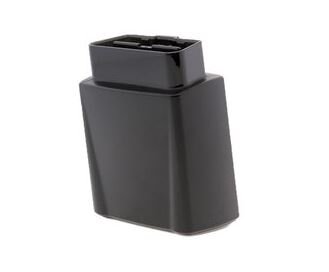

one might try one of those modules that plug into the obd11 port that allows modifing the information coming out of the ecm to change performance.

Good info, one company that sell the chip said it would not work if there's a tune in the ECM.
