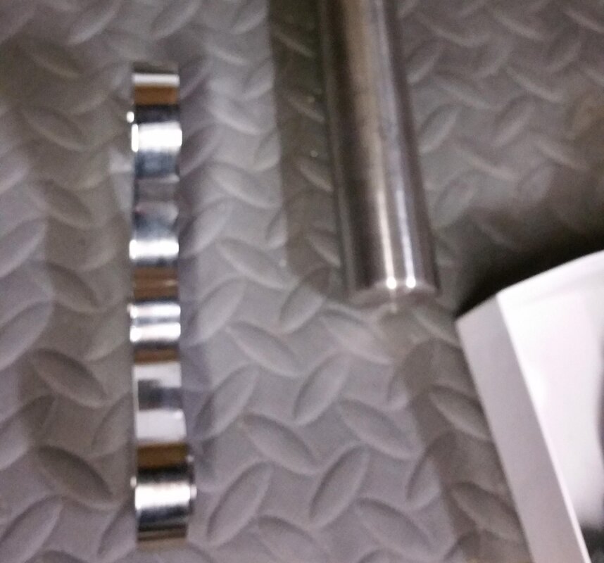

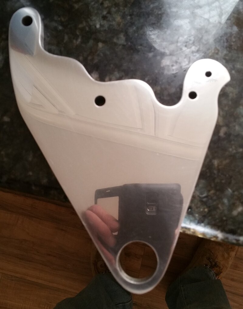

It might be easier to rough it in before cutting. But I did not, I started after cutting.
I roughed in with a 3m pad on a grinder.
Here is a part with a portion roughed in.
After this it was all wet standing down to 1000 grit.
Then the buffing wheel and compound for large parts and hand rag and mothers for smaller parts.

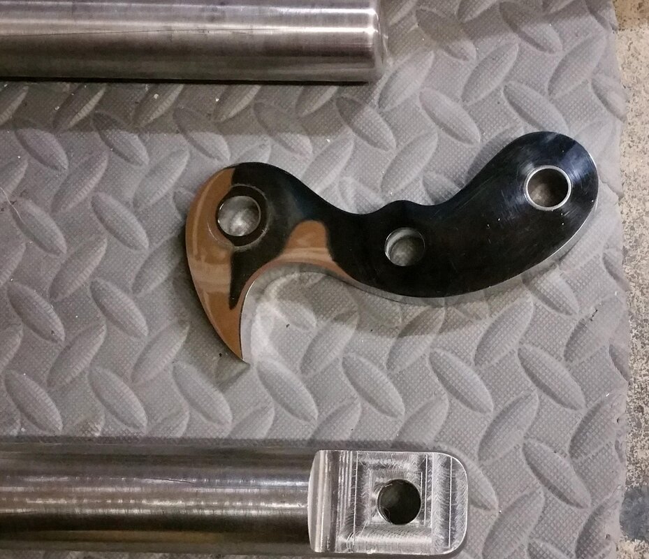

Okay I am a little excited, I went on the run to find a machinist who would do the work I needed done.
No luck in the local area's, like all closed up or changed what they are doing, so went to the welding supply store to get some SS rods and ask if they knew of any shops..... paid off big time.
So they are going to mill down the fork bars for me and align/drill rocker holes and later cut the bars to length as needed.

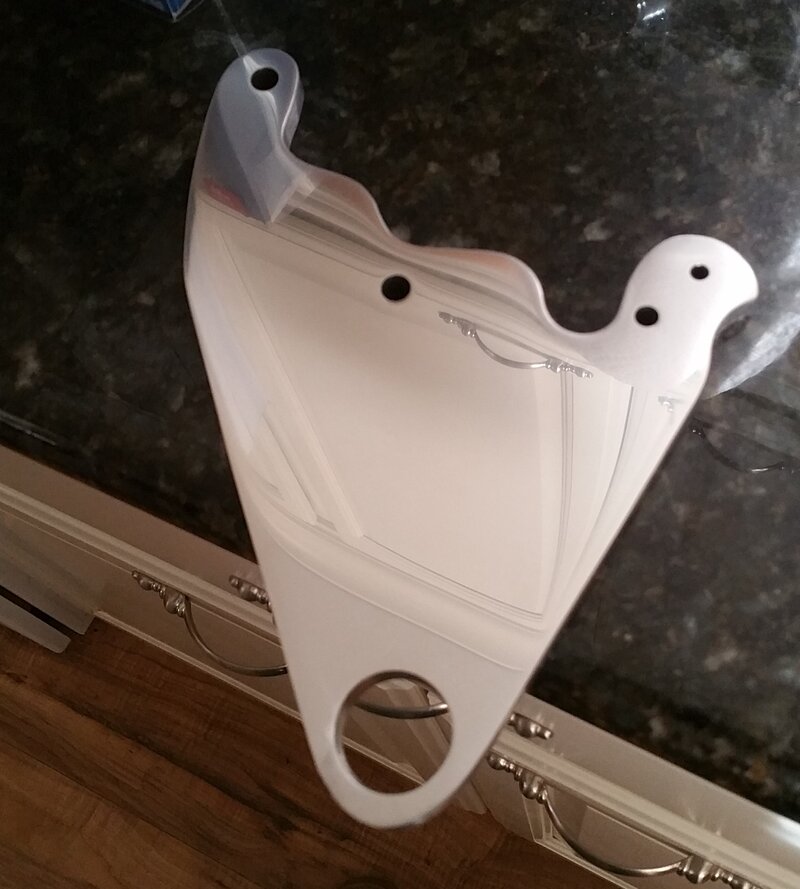

I spent the afternoon sanding out the brake stay. I spent the other day, most all day, with the 50 grit going over it and over it, yes I changed my paper, and in the end I worked that pit to pin point.
Now it is not noticeable after using the 400 grit in the sink.
I forgot that before I spent a day sanding I drilled the hole for the brake retention arm. All parts should be here Monday hopefully so I can take them to the machine shop. 1/4" x 20 thread is what it will be tapped to and I will use a should bolt to mount the arm to both the stay and the main fork.
So I still have 600, 800, 1000, 1500, and 2000 grit wet sanding to do. I think it is worth all the work, and than I get to do the rockers.

This what I would do.....waterjet the profile and pilot holes for the tight fitting holes and full size for through bolts. Then ream the tight fit holes on the knee mill.
You are educating us all well Rex, that is if you are wanting to do it right so all last a long time.
And I thought it was just drill a hole and push the bushing in, it would work if you knew the exact drill bore and bushing dia., but like I said, just drilled holes and thought all fits, LOL , live and learn.
The machinist is going to take a 27mm OD bushing I bought and press fit it in the brake stay after he does the final work to my rough cut hole. It is just a bit loose for the 26mm OD bushing.

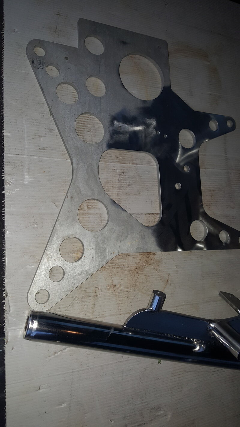

I was able to get my rockers cut out via waterjet, the cost for the pair was 60.00-----shop cost of course.
The brake stay is completed, well except I have a few new pit marks from the shop work that I will have to work out so all can be polished up (I just hope I can get them out)
Holes drilled in rockers was delayed because the shop dog at my paper work, four pages, so I had to do some over and make new copies for the machinist. He is a big old hound dog who loves the scent of my female dogs, LOL

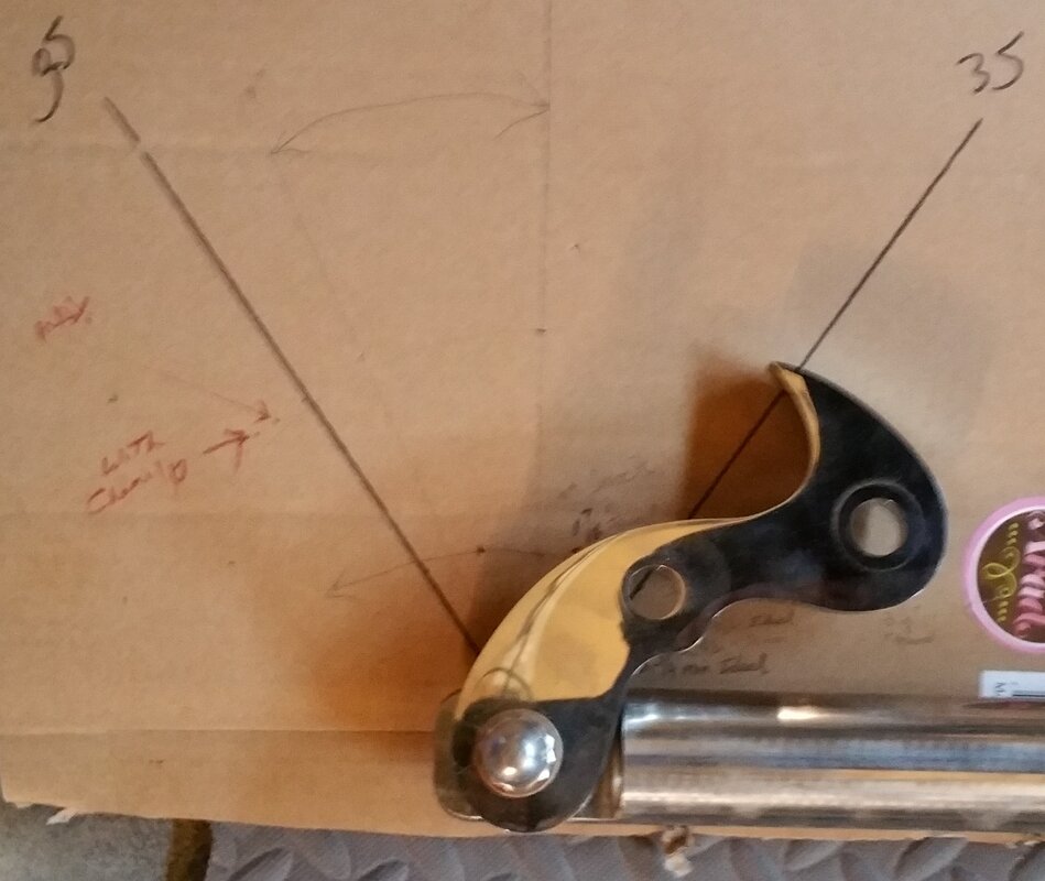

I had the machinist take off more at the end of the roundness(by a 1/4 inch)so the rocker has more swing room with out binding. It was tight and right, but no extra room, so had it done.
Once my arm heals and I have usage of it, well the fun begins.:D

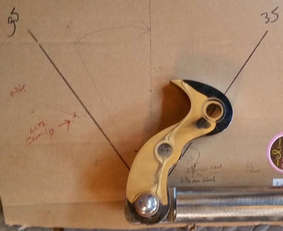

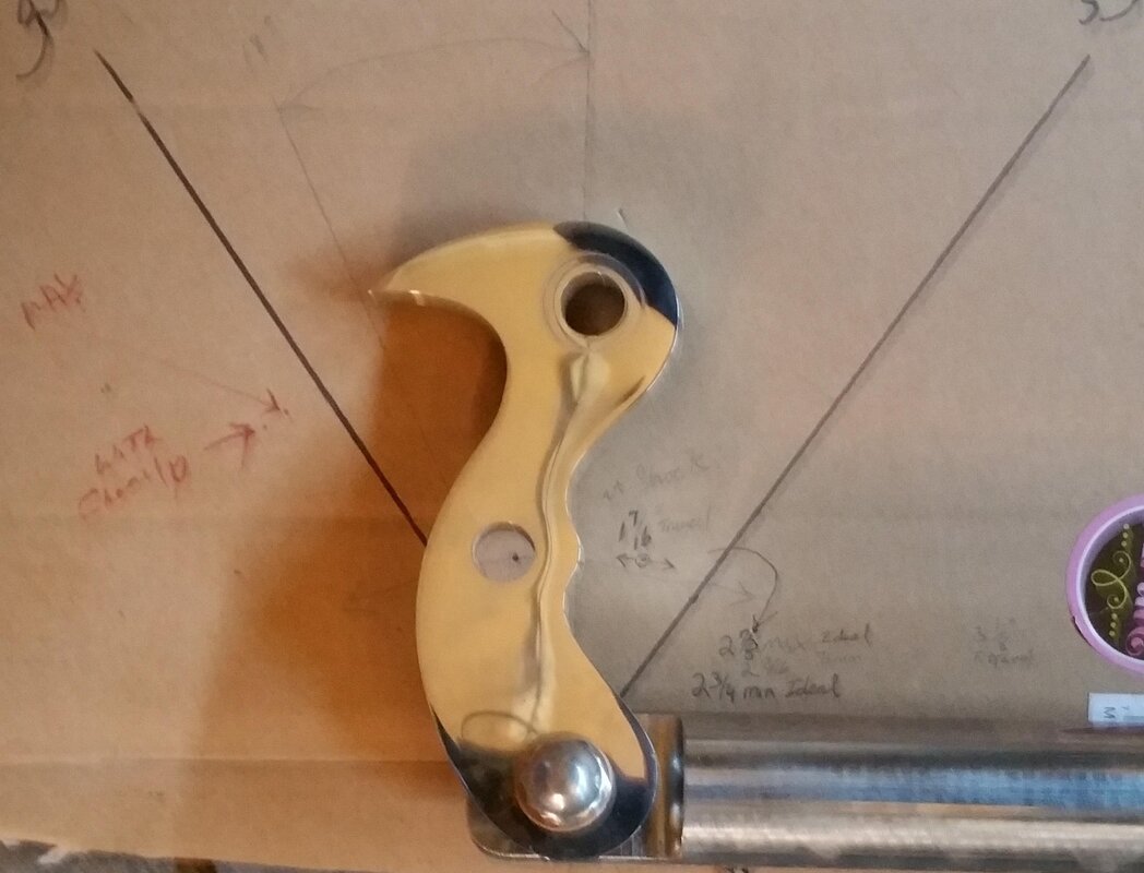

This is going tobe hard, at least 7 days with one arm and hand. These pics show rocker swing.
This will be the ride position of the rocker's, ( 90 degree's from the fork line )
And now as it travels back to compressed state.
With the extra clearance now the rocker should not ever bottom out on the fork bar.

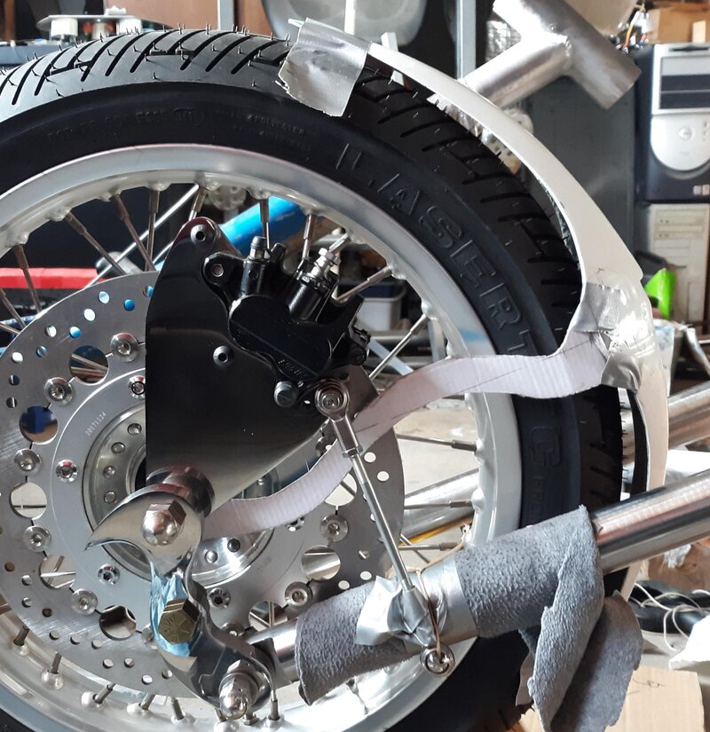

The fork bars are not at a 48 degree angle, so all does not really look like it will when all attached to trike.
The reaction arm for the brake stay turns out to be a bit to wide to mount on the inner side of the stay which than allowed a straight alignment to the inside of the fork bar, mounted it to the outside for now and if this is how it will mount I will have to have a offset reaction arm so either inner or outer side of fork bar. A super low profile head shoulder bolt just might allow it to mount on the inner side of the stay, something I need to check out.
The entire set up should look close to this position, the brake setup will be centered above axle and fender's exact location probably is more set by the pivot links at the top of the fender, still need to get them. Seen a kit on ebay for 79,77, and 59.00 dollars, but none are listed for a narrow glide front end, so I wonder about making what is needed.
