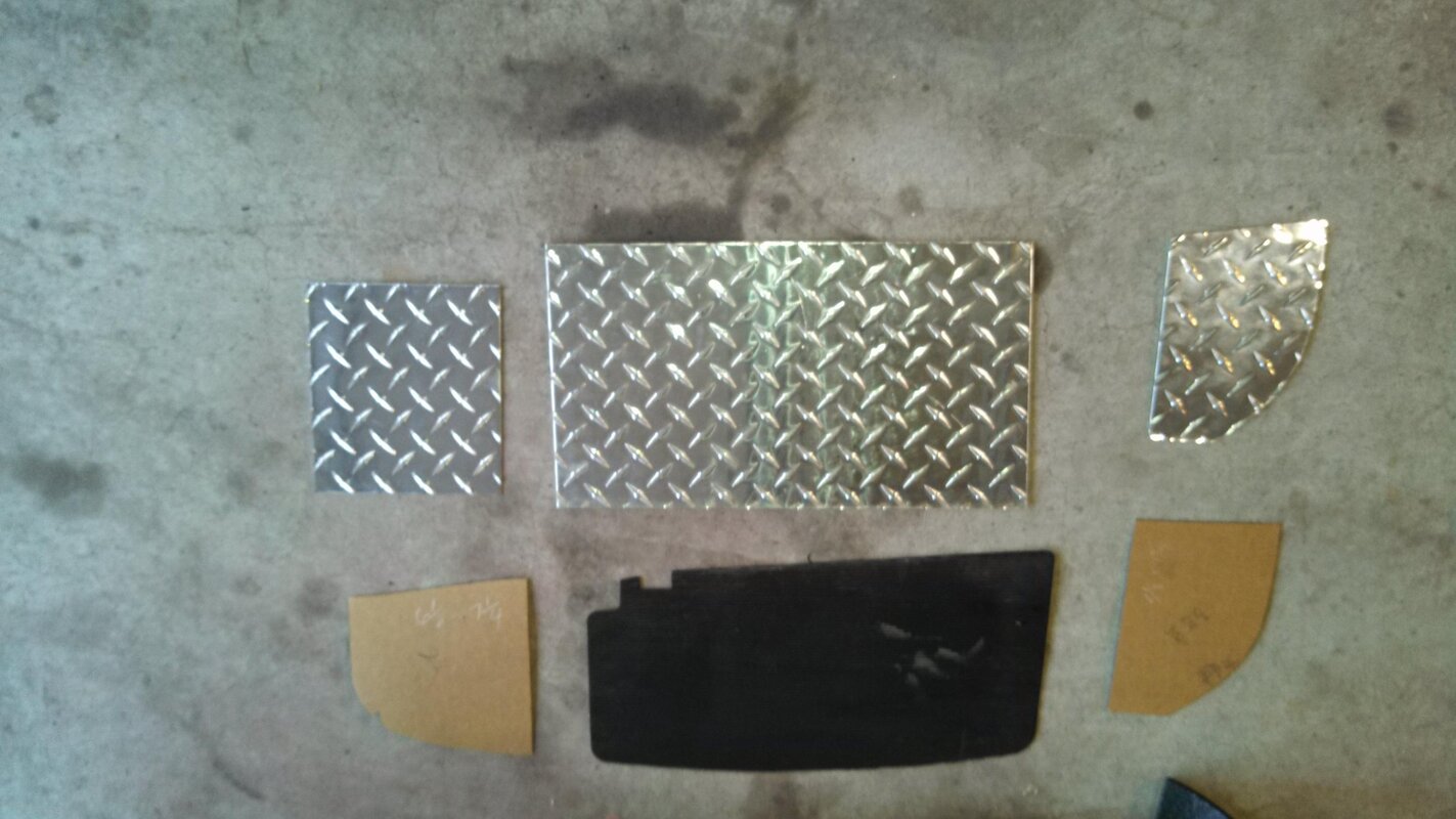

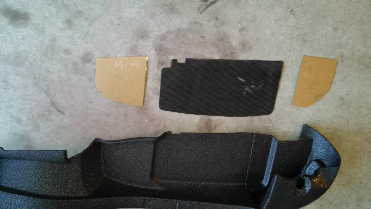

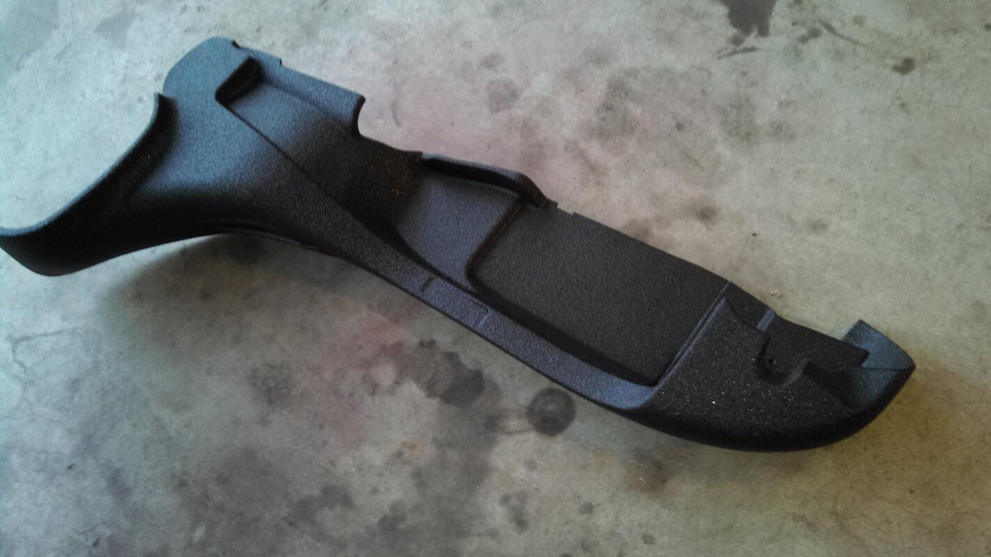

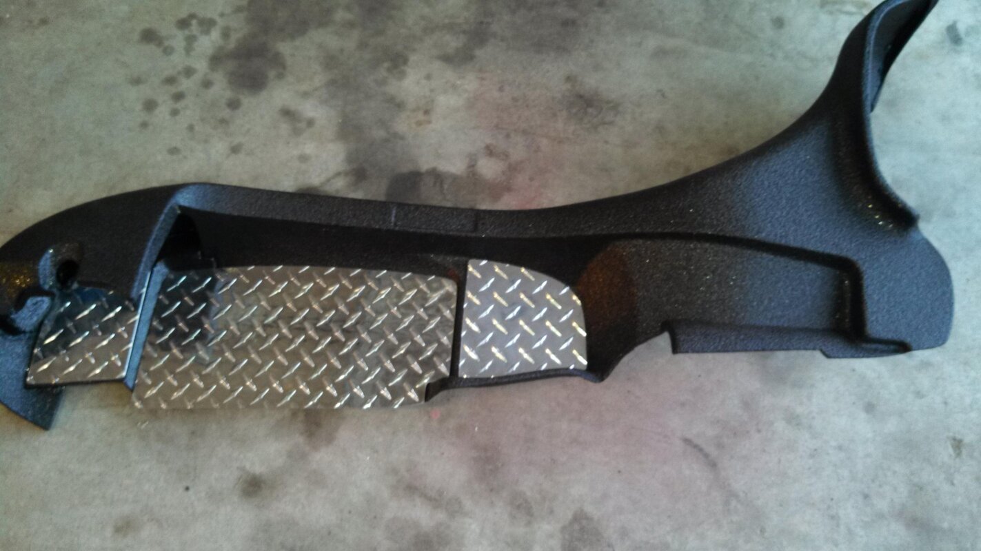

Just bought some aluminum diamond plate and will cut them to fit in the foot wells. With bolts that run through the diamond plate, the ground effects and the middle brackets they should be plenty strong enough to be considered weight bearing.
