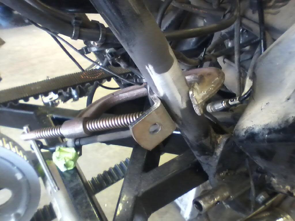

Three years ago I lost my left leg and decided to trike my 2007 FLHT. I chose the Champion IRS kit. The closest "authorized" installer was three hours away. The guy had a really cool web page. After talking to him on the phone he said he was offering a Spring special - free EZ steer rake kit if I ordered in a few days. I inked the deal and sent the downpayment without ever seeing his operation. When i brought the bike in for the conversion I couldn't find his shop. Turns out it was in the back of a complex of rental shops. It looked a bit sketchy, but I had just driven three hours to get this conversion started. Oh well.
I was given a completion date. It was pushed back multiple times for well over a month delay. I was told it would be ready on a specific date. Drove the three hours only to find it was not complete and no one bothered to tell me before I started the six hour round trip.
Okay fast forward three years and 20,000 miles. The trike rides well but when I got to Daytona for Bikweek, my back was getting sore. I stopped by the Mustang people to get a backrest installed. They couldn't install one. Turns out Champion includes two brackets with the kit that must be installed in order to mount the backrest bracket. Since I didn't have a backrest on the bike when I brought it in, they were never installed.
I tried to contact my installer thinking the brackets were still on a shelf in his "shop". Well his phone is no longer in service and that pretty web page is gone. Champion wants $225 for the brackets I already paid for.
My advise for those having their conversion done by someone else, make sure you pick someone that is trustworthy and will be around for more than a year or two. Don't judge a shop by their cool web page. If I were to do it again I would go with a well respected local shop rather than a fly by night "authorized" installer. The good news is I LOVE the trike.
I don't think Graham is 3 hours from Bedford but that sure sounds like what I think I ran into with a supposed installer there only I never even found the actual business. But it was supposed to be behind some other businesses and had a nice website. Young County Conversions I think it was. I'm still looking around but think someone at this site just might be the ticket if/when I'm ready to jump.

welding body bracket to left side of frame <input id="fullText" type="hidden" value="d-2- welding body braket to left side of frame" data-link="title]
exposed the metal on the frame for easier welding.,after i loosly bolted up the body frame and got exact placement of braket. I unbolted the oil tank and pulled it out of the way .
I held the bracket in place with a c-clamp for welding.
- See more at: http://s1273.photobucket.com/user/pc....eMrjtPRK.dpuf
By chance, would someone have an extra set of those brackets just collecting dust on their workbench? :(
easy to make with a torch, grinder, drill, vise,piece of 1/4" thick strap. Just need some pipe to bend it around, harden when finished.
Or contact Champion?
There is a link to their website at the right hand side of the page. Hope that helps?
