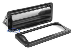

Thank you both for the information and the advice. I have had the fairing apart before to install some components for my J & M CB. My next question is about the roll up door feature on the inside fairing that covers up the radios faceplate in bad weather. It appears that this component is holding the radio in the fairing? Do you know how to remove this from the fairing without braking it? Does it just snap off? I do not want to beak it because I probably can not replace it and I want to reuse it. The reason I asked who made the fairing is because I was hoping to find some instructions on how this feature comes off and on. Any help would be greatly appreciated.
If you look at Lee's picture the outer cover does pop off and then for machine screws hold the inner on. Just use a little plastic pry tool like for interior work, harbor sells them cheap, and pop it right off.
