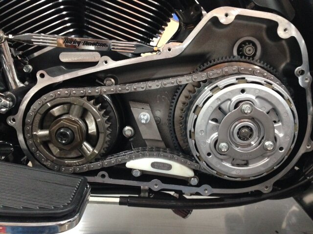

Last night I removed the Hayden adjuster from my primary.I was concerned about how tight the chain was with with the Hayden.Even without shims I could not get the 3/8" travel they recommend. I replaced it with the Baker Attitude Adjuster.More work to install ,and more work in the future to adjust. The results seem to be worth the expence. Neutral easy to find, clanking from compensator is much less ,shifts better (although still a bit noisy). I put 30 + miles on this morning , only time and mileage will tell. I have always used Hayden in the past ,but this new one does not perform like the old ones did.Baker attitude adjuster.jpg
i had the baker attitude on my streetglide and just havn't installed it yet in the new trike. it was a great improvement over the stock one.
Just had the Baker installed in my 14. Did not seem to help the shift clunk much, but the overall transfer of power seems much smoother.
That baker chain adjuster is similar to the ones used on the older bikes except they have finer adjustment capabilities.

Yup, did the adjuster first and will do the comp over winter as they become more available. High demand right now. The other thing is, not many reviews yet with any high amount of mileage.
