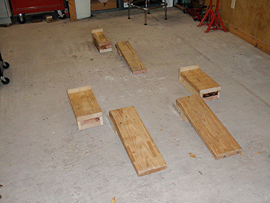

Gold Rush on this forum sent me a set of plans to build ramps to drive up on, not back up. I built a set of three ramps. They don't look as good a Gold Rush's but they work. Send me a PM with your email and I should be able to send the plans to you.

But now that I look at Gold Rushes' pics, might build me a set of three, and fix them so ramp part can be used on either end of block portion so drive on / drive off as needed.

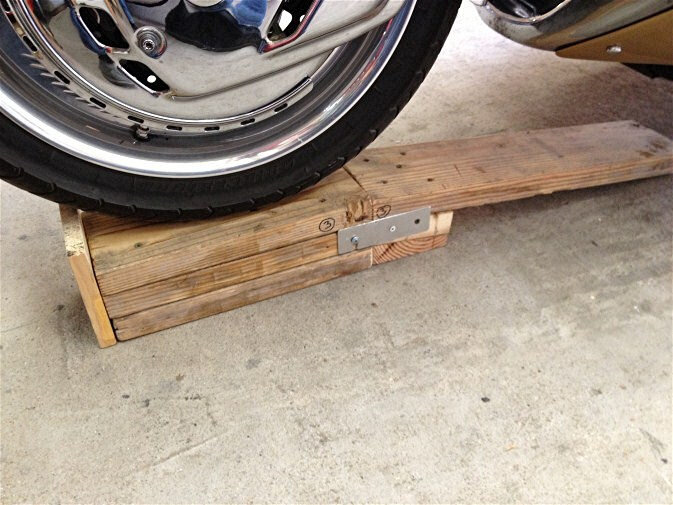

I took a 10x12x2 board and cut six 6 pieces a foot long and then glued&screwed two of them together.... so now I have 3 one foot boards and jacked up my bike and put one under each wheel.. This lifts the bike up 4inches, high enough to at least work under it, to change oil and filter..
Ronnie
