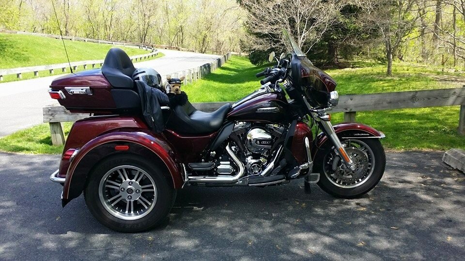

I'm glad mine is a 2014. The upgrades are great. We use the GPS all the time and have no issues. All my favorite music is on a USB memory stick plugged into the fairing port. Twin cooled 103 is a beast. I've added chrome, de-catted the stock head pipe, added Nightrider FL-ViED-10 fuel enrichers, shock lift kit, tour pak level kit .... and could not be happier. We have over 13K miles in 14 months .... and live in S.E. PA. I am not a cold weather rider!
Bob :Dorag:
