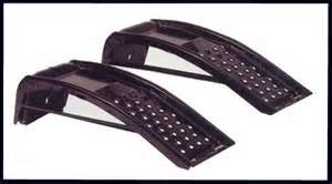

I've never tried it, but I've heard of folks using those drive-on automotive ramps to either drive their trike on or back it on, but it would have to clear the fenders. Have any of 'yall ever tried that or seen it done?
Something like these...
The new style car ramps work good. The newer style are just lower with a loner approach to clear the car fenders.
Got to do it in reverse if you have running boards.

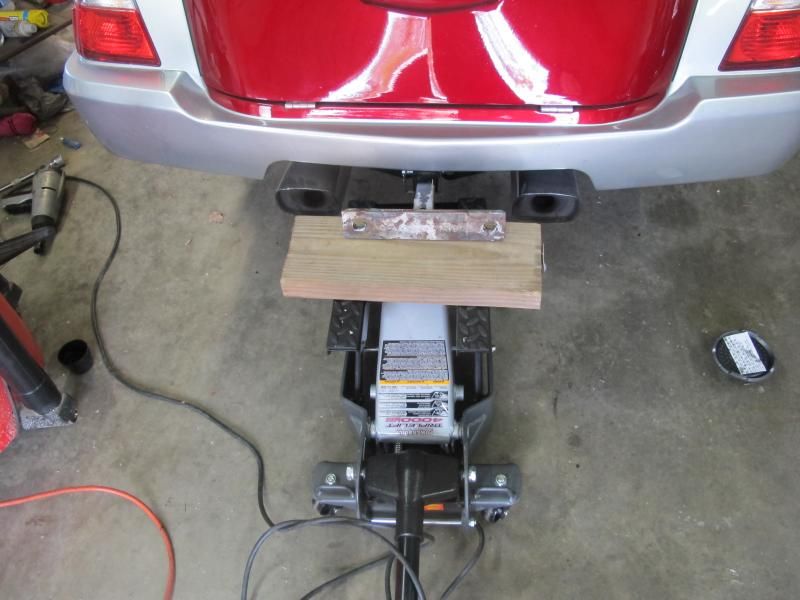

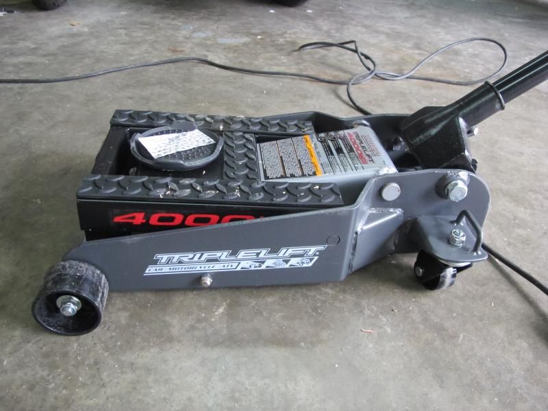

I use this
$129 at home depot. rated at 4,000 lbs.
My 1,000 lb bike jack will barley lift the rear off far enough to get the tires off.
This jack will clear the mufflers.
Roadsmith said the trailer hitch is strong enough to support the rear end.
