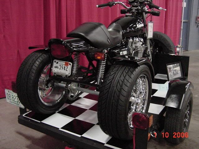

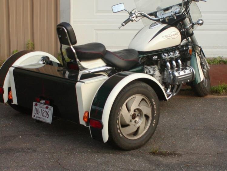

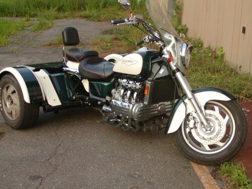

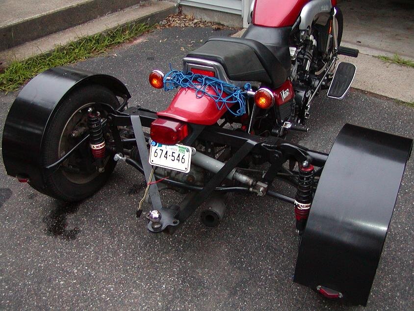

if you are interested we might do something like one of these for you.. independent suspention an electric lean that compensates the crown in the road..

With that you eliminate the rear wheel ( hard to tell from picture) so it is a true trike.
Anyone that say they are as good as a REAL trike are kidding themselves. They work as good maybe, because you don't fall down , and you do not support the weight. That is were the similarity ends .
john did you mean pics i posted?? they have 3 wheels and independant suspension
Yes pictures. I think I talked to you a few years ago at Conn motorcycle expo in Hartford.
can this be one of your early ones
nope... my 1st in 79 was the only one without indepenent suspension dont care much for the quad axle on a bike bike.. i had the red one there probably close to 15 yrs...
