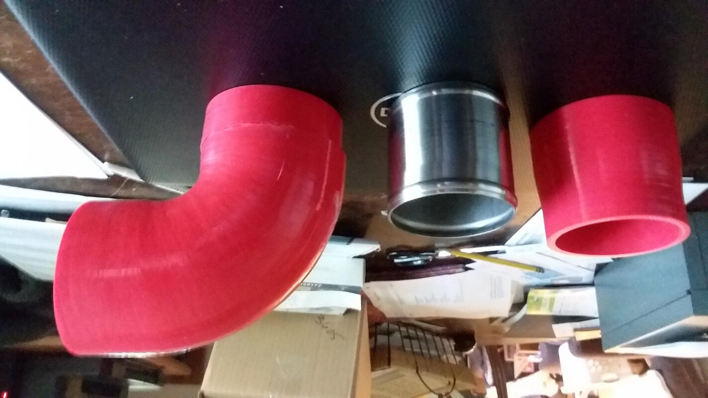

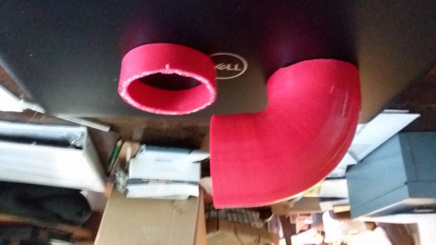

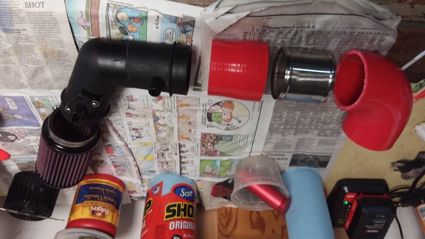

I did the above fix for my beast, but i really did not like the look of it.
got these online 90 degree 3 inch$16.99,3 inch reducer from 3 to 2.75 $11.99 and stainless steel joiner $7.99 and i added a new air filter $45.
They are silicone
don" know why they are upside down. I cut 1.25 inches off one end of 90 and it sits
just like the old one did. comes in red, black, robin egg blue
They are silicone
View attachment 99020View attachment 99021View attachment 99022View attachment 99023
Dragon

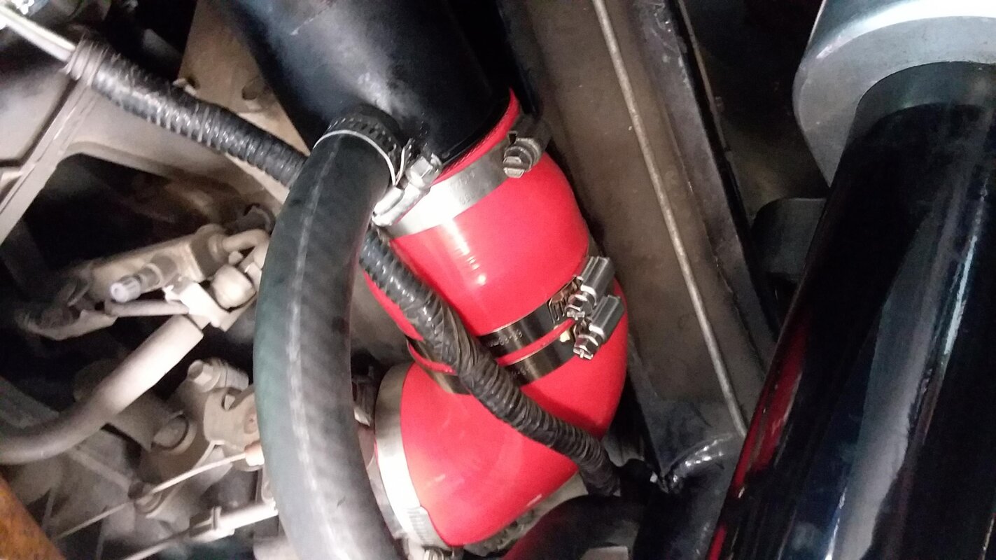

456D9103-48AE-4517-9C9F-2558C9DFA8B6.jpgE9445685-A18E-4A6C-9875-9A2B2624C0A5.jpg It’s been a while since I did the repairs. Don’t remember if I had to purchase new clamps or used existing clamps. The adapter for both ends of hose is supplied. The second adapter is not seen. It’s in package but it’s in the end of the hose. I hah no issues with it. Ran bout 50,000 miles with it and was still good when I sold Stallion last fall. :wave4:
View attachment 99280View attachment 99281 It’s been a while since I did the repairs. Don’t remember if I had to purchase new clamps or used existing clamps. The adapter for both ends of hose is supplied. The second adapter is not seen. It’s in package but it’s in the end of the hose. I hah no issues with it. Ran bout 50,000 miles with it and was still good when I sold Stallion last fall. :wave4:
Thank You. I appreciate the info. Rick
