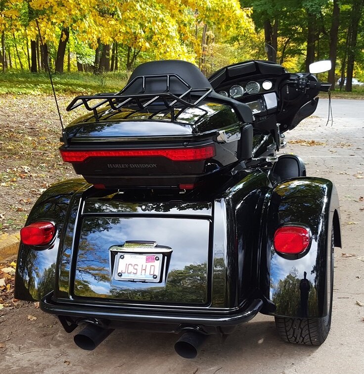

I put the SE Street Cannons 4" mufflers on my '14 tri-glide and that's all I did to the machine. Sound is really sweet when you accelerate, and just a deep rumble when crusing. I love it and it works for me.ThumbUp
Alan, I picked up my 14 Triglide last fall and I was pleasantly surprised with the stock exhaust sound. Harley definitely made a change with the 14’s to sound much better. I had Bub’s on my 2008 Ultra Classic and I really liked the sound but after a few years they were really starting to get a little bit too “loud”. When I went to the Triglide the exhaust was one of the first changes I was going to do but once I heard the sound of the stock exhaust I was very pleased with it. I had to get my wife to “blip” the throttle several times while I stood in back of it to make sure that it sounded like a Harley, and it did!! Another benefit is I can really hear the new radio and don’t have to blast it to hear it! I’ve also had several people ask me what kind of exhaust I have on it and I say stock and they can’t believe it. If I was you I would put your money into some accessories and wait until later….
