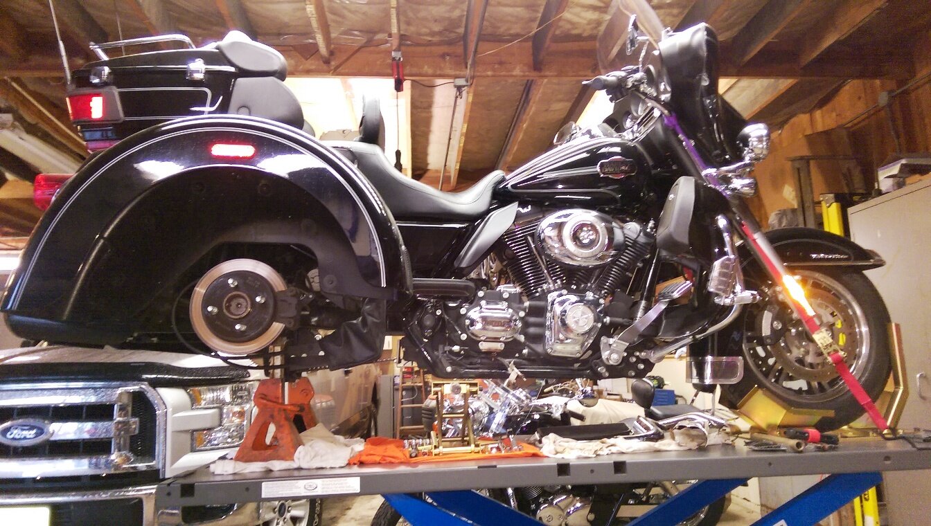

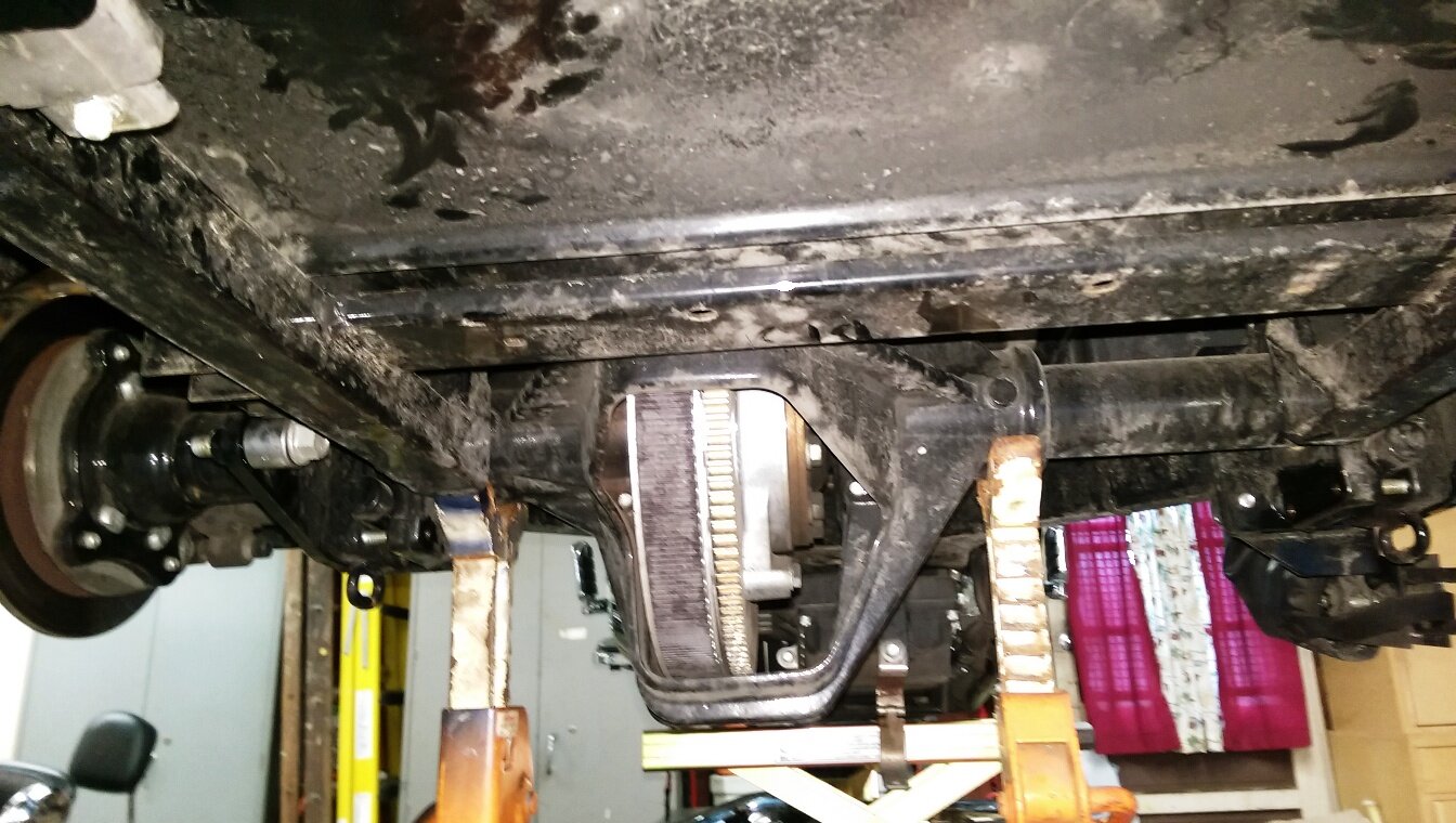

And so it begins. The new lift arrived today and we were able to get it off the truck out in front of the house while it poured rain. We managed to get it all unpacked and setup. Drove the trike on the new lift for the first time. It all went real well and this lift is very strong.
I managed to get it jacked up and then took off the rear wheels. I took off the right side foot boards and then the exhaust pipes and mufflers.
I drained the trans and put on the Easy Boy Clutch setup and buttoned that all up. I cant wait for tomorrow and start on several other items on my list.
Thanks for listening.

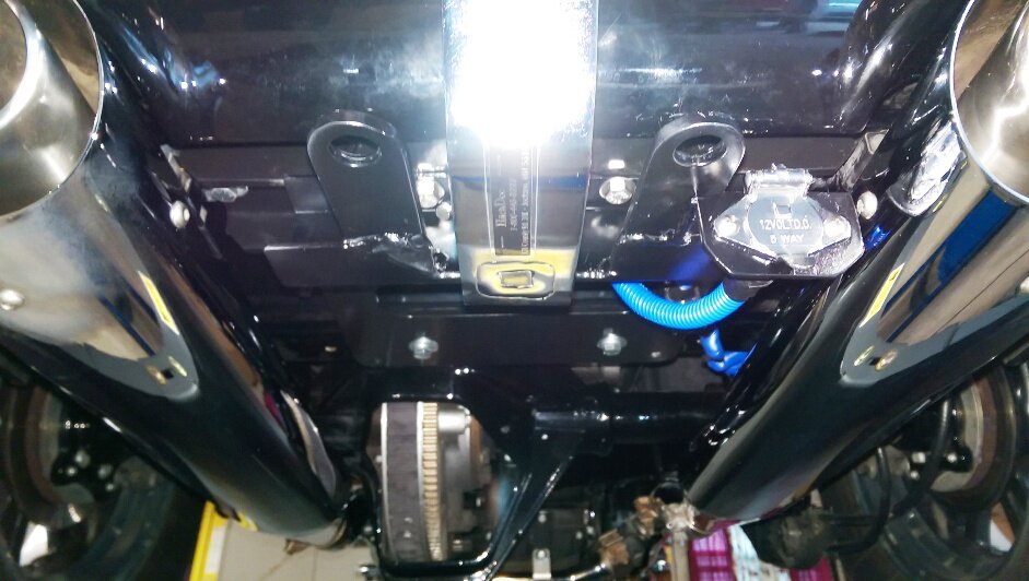

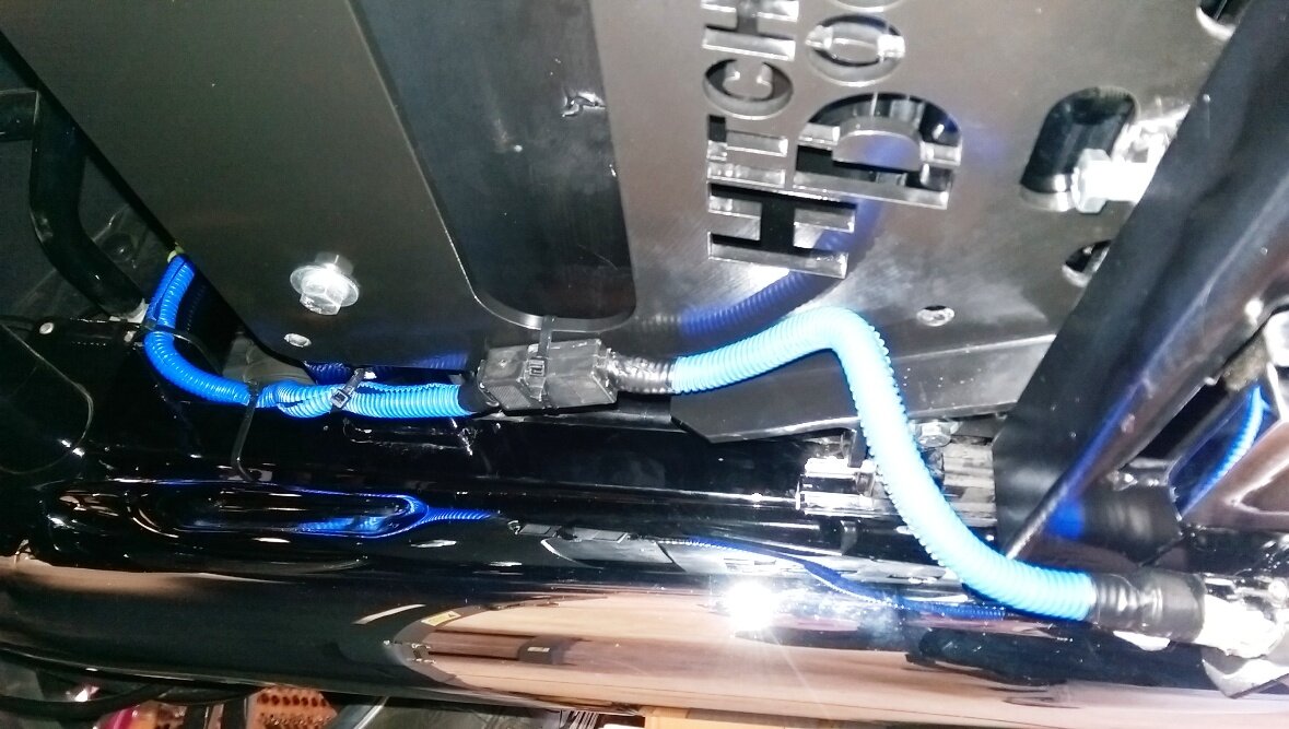

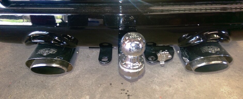

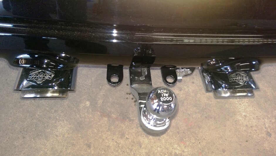

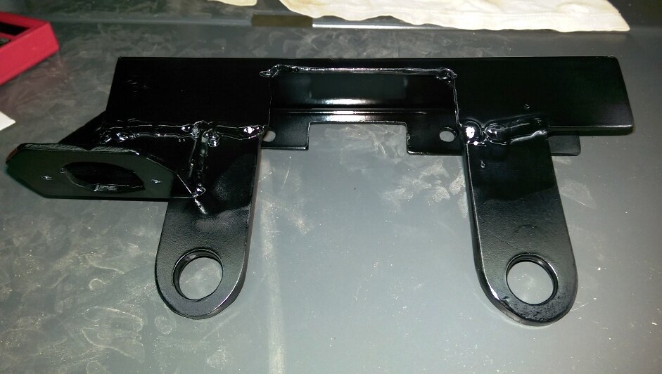

All done now. Lift kit, Mufflers, De-Catted, Breather Kit, Easy Boy Clutch, V & H Fuel Pak, Trailer Hitch and home made Trailer Hitch Bracket for Harness and Safety Chains. I didn't like the bracket that came with the hitch so I made my own. Trailer is wired and ready for the road. All is good.
