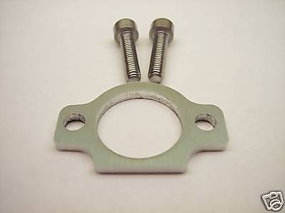

Some of you may know that I was having a time with blown seals.
Someone told me to disable the ADV valve on the front fork. I was hesitant because I'm not one to disable something that the manufacturer put in (but I will rip off the rear end to make a trike.. go figure), but anyway.....
About a week ago I the seal blew AAAAGIAN. so i figured what the heck, I ordered this kit from ebay
http://www.ebay.com/itm/GL1800-GOLDW...d15e5&vxp=mtre
I got it Saturday and put it on last night.
Welllllllll
When I pulled out of the garage I knew something was different. I felt absolutely NO bumps in my drive way.
It was actually scary, bumps and jars that I knew I hit yesterday going down street WERE GONE.
I went and tried to hit a few, and I swear that I could NOT feel them. The front end went from harsh and tight, to silky smooth.
As I said before I am not one to disable stuff, but had I know that by disabling this the ride was going to be that good; I would have done it the DAY I bought my bike.
ITS THAT MUCH OF AN IMPROVEMENT
So, I don't care...
find a nickle drill a hole in it,
buy this kit,
or buy some cut washers,
or whatever you have to do.....
DO this and you wont regret it...
It was just that much better

The original design of the ADV was to eliminate front end dive when applying the front brake. Which also increased the harshness of the ride throughout the front fork travel. When you disable the ADV it does allow a little more dive under heavy front braking but it more than is offset by the smoother front travel over minor bumps.
Standing in front & looking head on at the forks, you will find the ADV at the bottom of the right front fork. You can take out the two allen head bolts and separate the halves without the loss of any fluid. You can then place a nickle, drill a 3/16 hole in the center of the nickle first, in the lower cup and replace the top half. Be careful to not over torque the top half.
Pictures would help. What years have this ?
ADV.jpg This is what the animal looks like John. As far as I know all year GL1800 have them. I can't believe Honda would have changed for 2012 and later but I have never worked on one so I don't know. The two dark circles are the cap head bolts to remove. It helps to have ball allen wrench but if you have a long shaft allen wrench you can probably get to it.
As mentioned earlier there is no danger of loosing fluid or getting air in the brake system. If you happen to have a piece of 3/16 inch aluminum laying around and some patience you can fashion a spacer like showed and then pick up a couple replacement (longer) cap head bolts. I did this several years ago... :xszpv::xszpv:
I'm most likely the only one confused by this pic however, the screw head circled to the right is the one to remove. Along w/the same looking screw on the other side of the valve.

By installing the nickle your keeping it from pushing down on the ADV.
This mod which takes all of 5 minutes makes no sense to me.
What does placing a drilled nickel in the space do??
Is it the nickel taking up what would be a miniscule amount of space proving less fluid volume??:xzqxz:
While the shim kit adds volume???
By increasing the space.
There are 2 functional parts to the ADV
the top part = the plunger
The bottom part = The actual valve
The plunger is activated by you applying the brakes presses down on the actual ADV valve in the part of the fork that it is attached to below. So it is a plunger that is operated by brake pressure the presses down on another valve that controls Fork fluid.
By putting the spacer/nickle/shim in between the 2 units (plunger/upper & valve/below) you are moving the plunger further away from the valve so that even when it (the plunger) is activated it will not reach the valve that it is intended to activate. THUS defeating the ADV function...
hope that helped

Jay I don't think this spacer totally disables the ADV. I have one and I can still lock up the forks by stepping on the rear brake peddle. That is how I was told to verify the ADV was indeed working. There may be a way to totally disable it but I don't know that trick. I do think the spacer lessens the harshness but like you I still feel some bumps and my front does not dip when braking. :xszpv::xszpv:

By virtue of how the system is designed ADV should not come into play until the brakes are applied. If it is sticking then I can see really bone jarring bumps happening. Soon after that there will probably be a blown fork seal as well...
My '01 did that not too long after I bought it when the GL1800 first came out. I guess HONDA redesigned that area some because we don't have near as many failures as the early years did.
In a way I think its funny. When this mod was discussed a few weeks or days ago.
I did it using the drilled nickel. I ran it for about 10 days and felt every little ripple in the road.
I just took it out Wednesday night and to me my front end is better with the ADV.
So as I thought right from the beginning.
I must have progressive springs in my forks.
When and if I find a need to have the springs changed I will go back to stock springs.
I hope for you this solves your seal problems.
