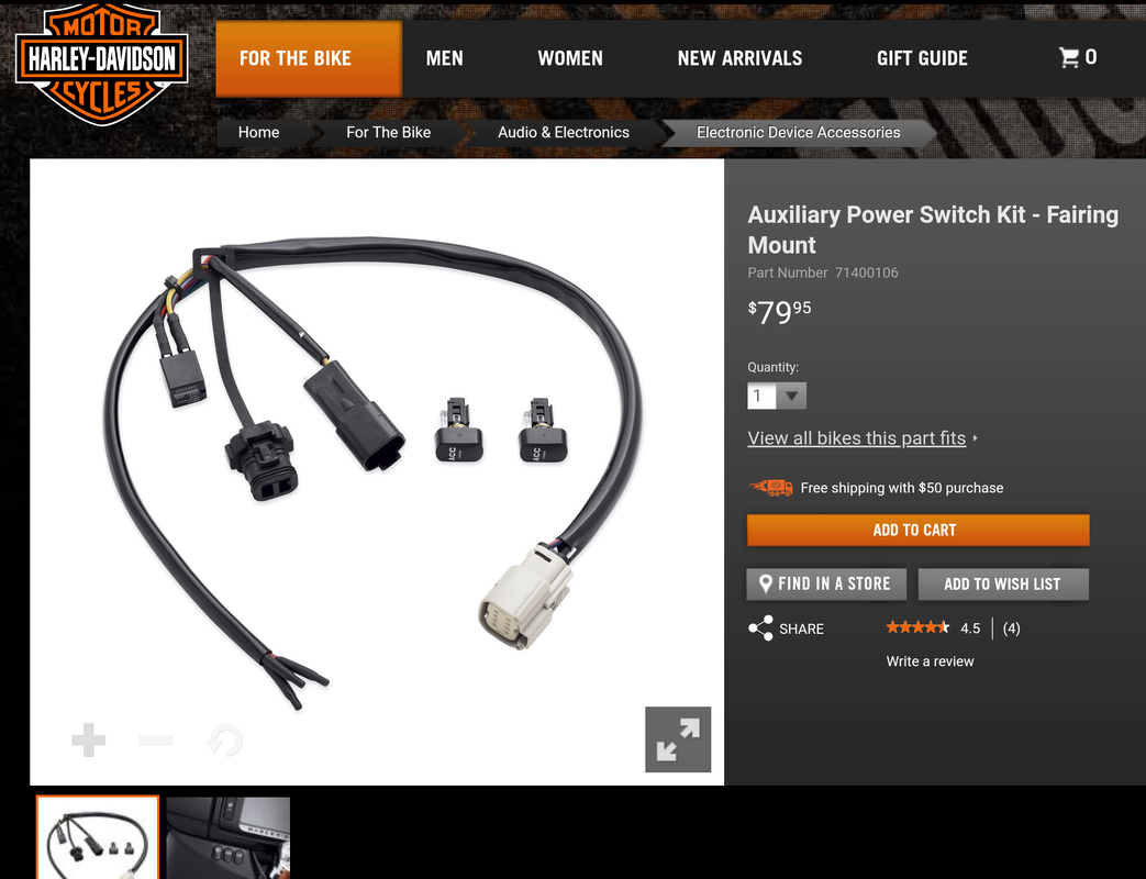

I've been trying to find a "Y" type connection/harness that would allow us to connect to the Accessory Connector left side cover and give two of the same connection points. Right now my Auxiliary Power Switch Kit harness that's connected there allows me connections for two electronics, but I loss the ability to connect my heated seat to the Accessory Connector.
Any one know if such a cable/harness is available? I do keep track of the total current draw being presented to that connection.

I been reserving that type connection for a heated gear connector connection point through the heat shield below the seat. But if all else fails.....
I also want to minimize the amount of spaghetti underneath the seat and battery compartment, because space is already limited due the Auxiliary Power Switch Kit Harness and its attached relay.
I could make one myself, but for insurance reasons, I would much rather have a moco or aftermarket manufactured part installed for this puspose.

Thanks!....I actually bought that adapter harness in December, when I first began getting the parts to use with the Auxiliary Power Switch Kit harness and the left side Accessory Connector. After it arrived I immediately saw that it has 4 Pin connectors and the male end won't fit the Accessory Connector's 8 pin connector, and its 4 pin ends won't connect to the switch harness' 8 pin connectors or my heated seats 8 pin connector
That's when I realized it wasn't going to be an easy find for a plug and play "Y" type harness to connect things the way I wanted. I know for some this seems over kill and unnecessarily, but I'm of the opinion that we all don't have to have cookie-cutter trikes, or be stepfords in our thinking and approach to modifications.
