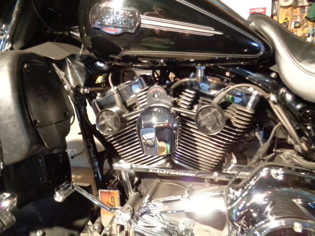

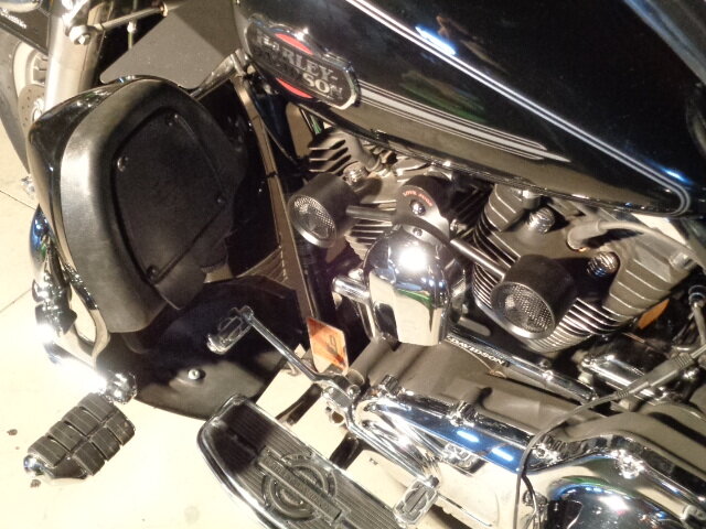

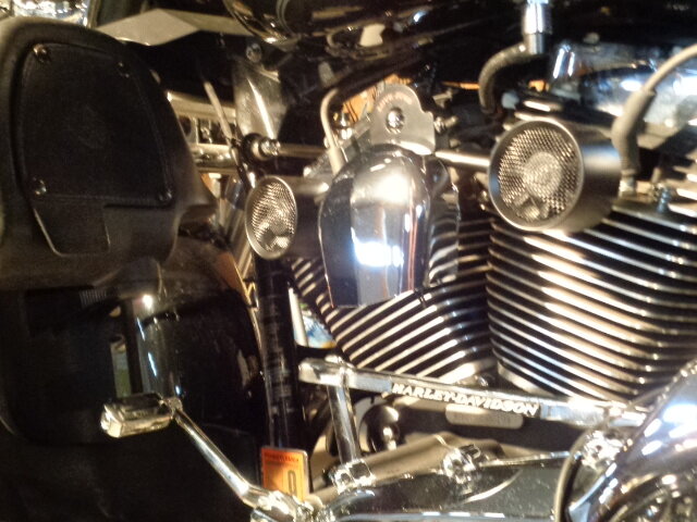

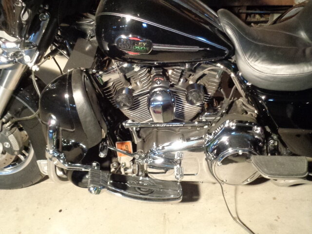

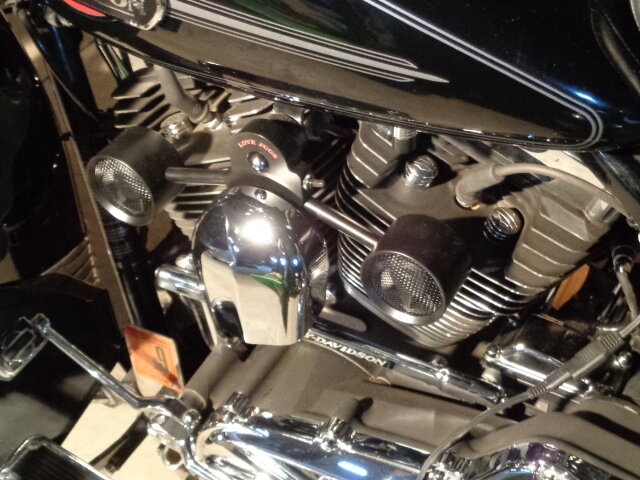

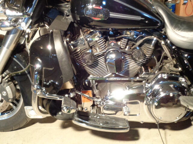

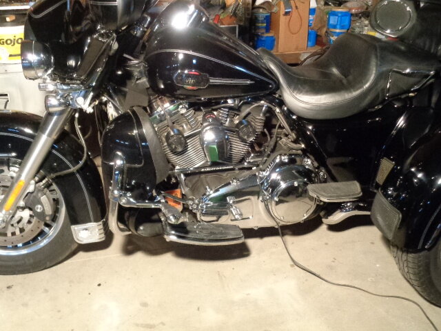

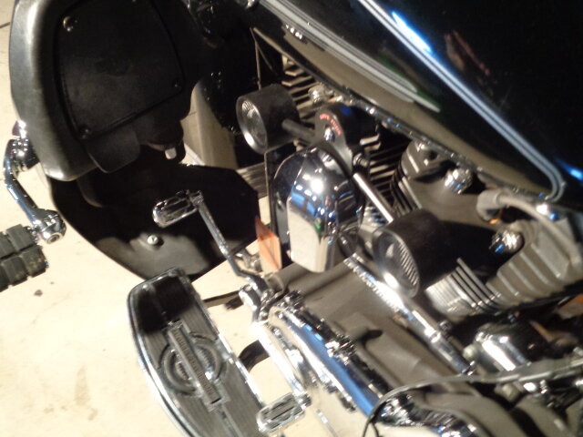

Installed all went well...
I must have become impatient with OEM Isolator, I ripped it up. I ended up removing horn mount from heads much easier for me to finish removing isolator rear portion.

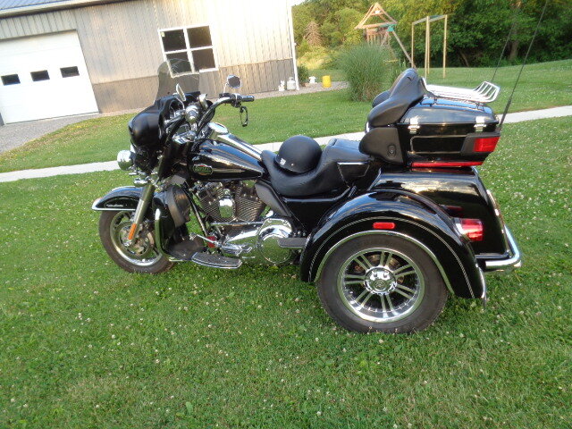

Quality material and workmanship in my opinion. Plug and play as in the directions all went well. Cold and rain today in Pennsylvania no riding yet soon I pray. As promised before and after pictures included. :good: Ride safely Fred

Today was our first ride of the year, the Mighty Mite's seem to be a great addition to Old Shiney. Going through the small town of Clarion the temps would climb quickly above 250 now stayed below 235. If those reductions stay the same in warmer weather those little fans are an expense well invested in our ride.:good: ride safely Fred
