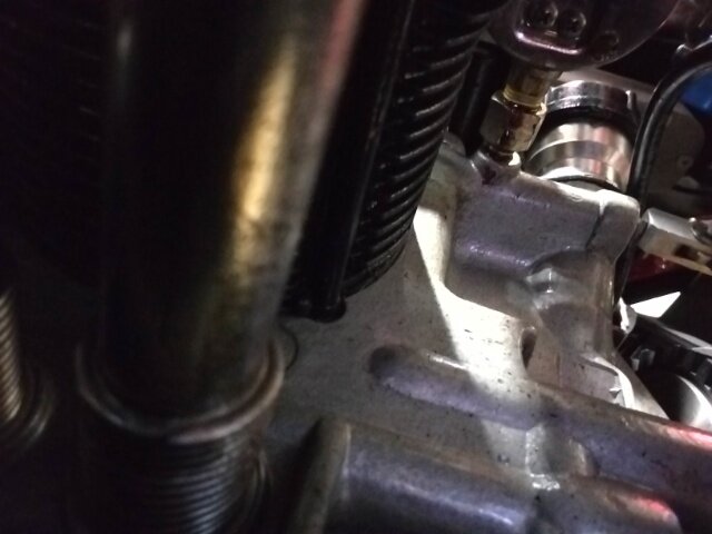

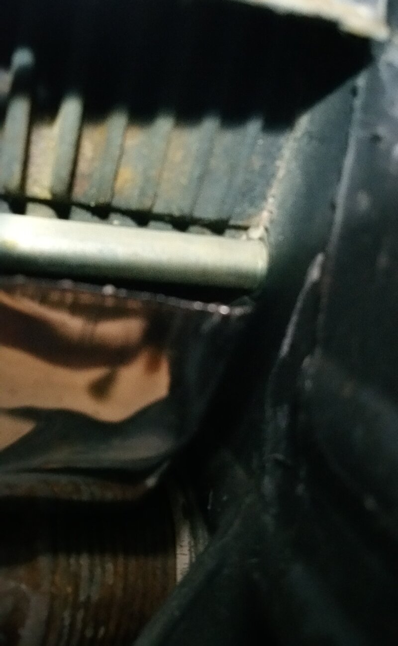

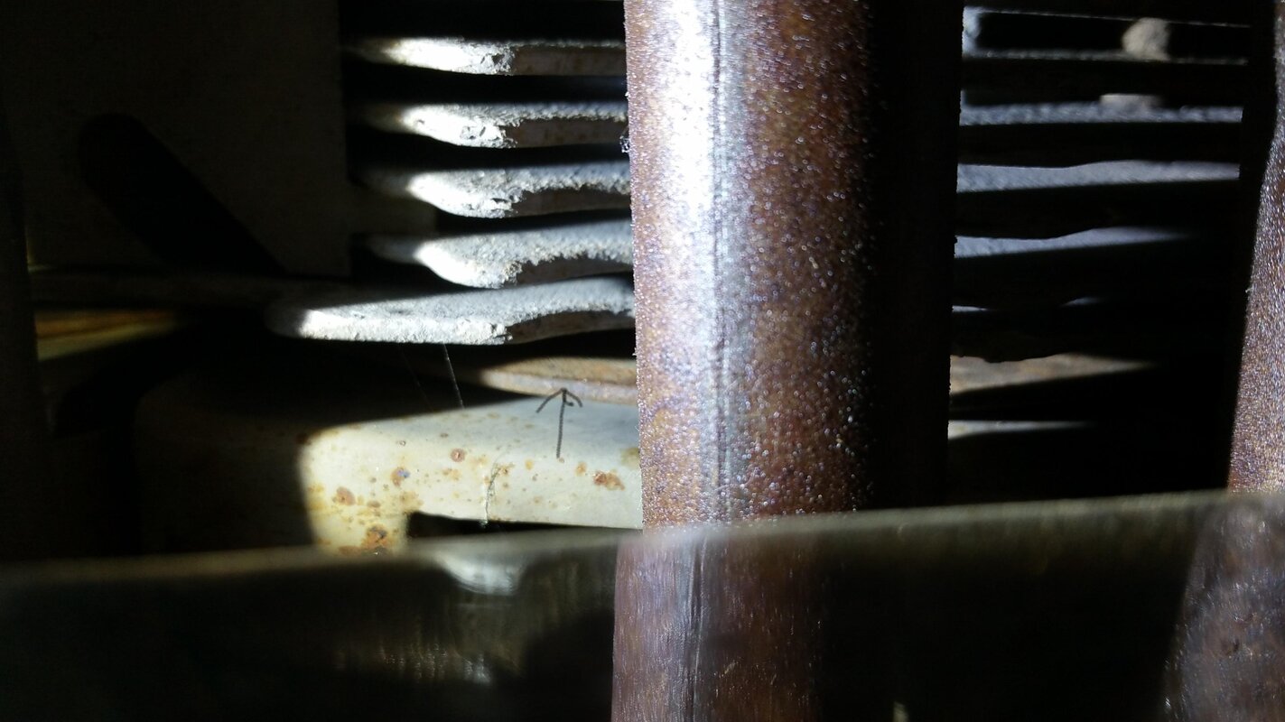

I took a picture of what I thought might be the shim you mentioned.
that wheelie bar is in the way a bit, another try.
The the top are of the pic is of the cylinder head, as the push rod tube goes down to the case, at the bottom area of the photo you see that other tin I mentioned, just up a little that the shim ?
It looks like you are at the head end of the cyl.
I can not quite place where you are.
But if it is shimmer at the head to cylinder joint you will not be able to see it.
Under the cylinder to the case joint where the head studs screw into the block.

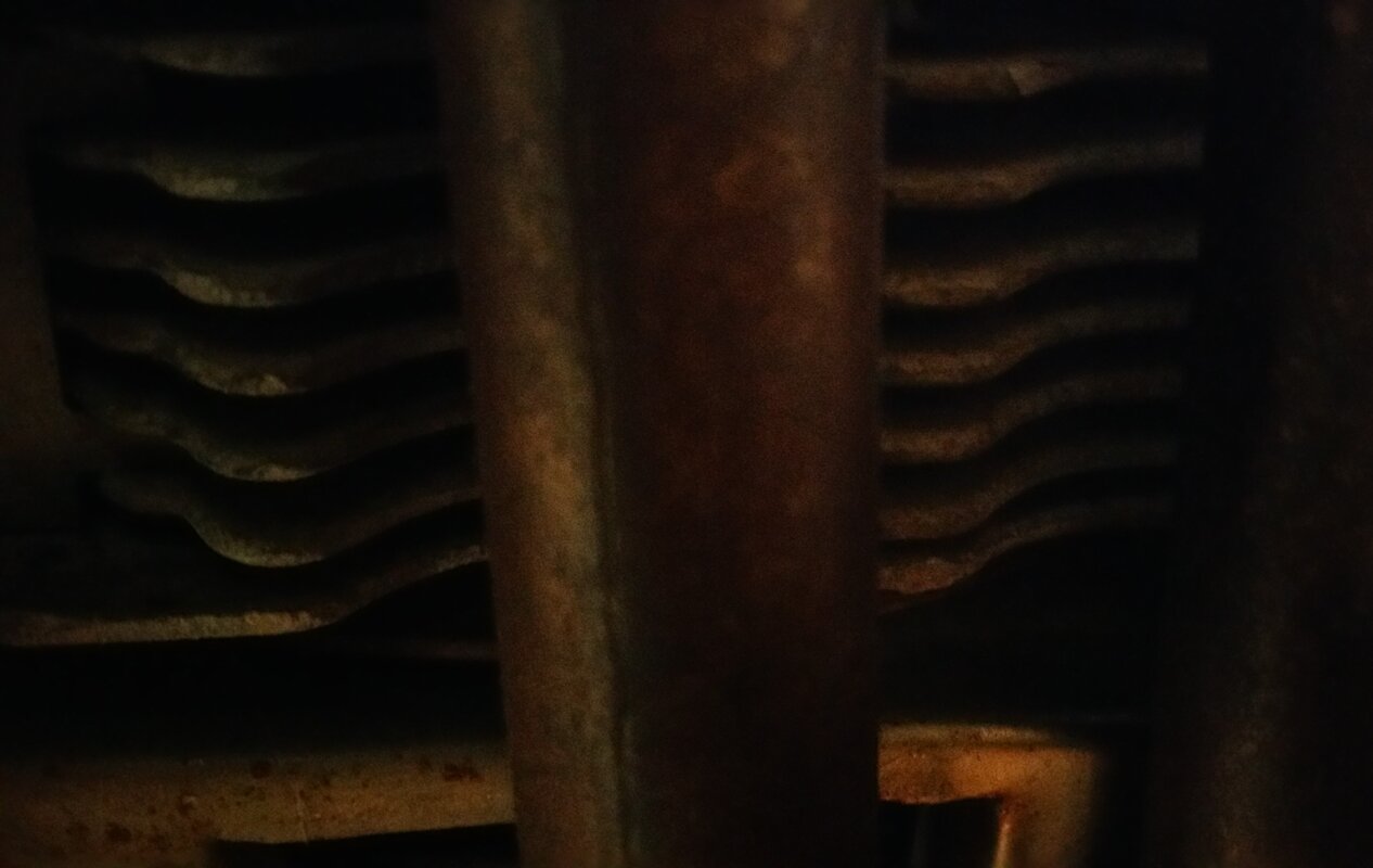

I am at the shop working on an leaking oil hose on mine right now. Lemme see if I can get a pic. Mine has huge shims.
At the base of black cylinder.
Hard to see as all painted black together.
NOT the head end. Even though mine is shimmer. 050 there also.
wow, a very clean engine, but did not expect less from you. I am sure at first this engine looked that clean, but now it has the layer of crude, oil and fine dirt, road grime. I will get it cleaned up so I can see better, and yes I was the wrong end again. So this does prove what another said, really get to know and understand the engine before rebuilding it, it will make all the difference in the end. I totally agree with this, off to the garage I go

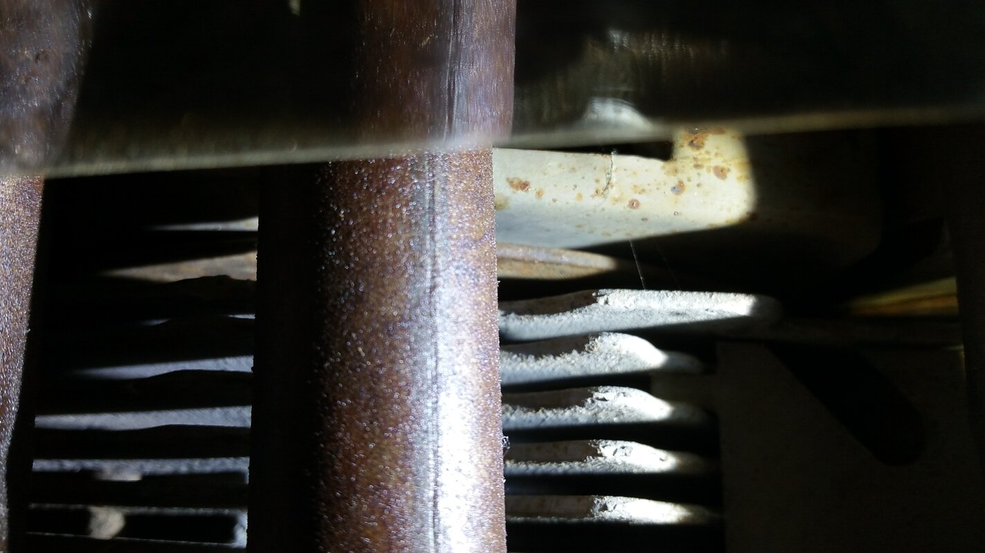

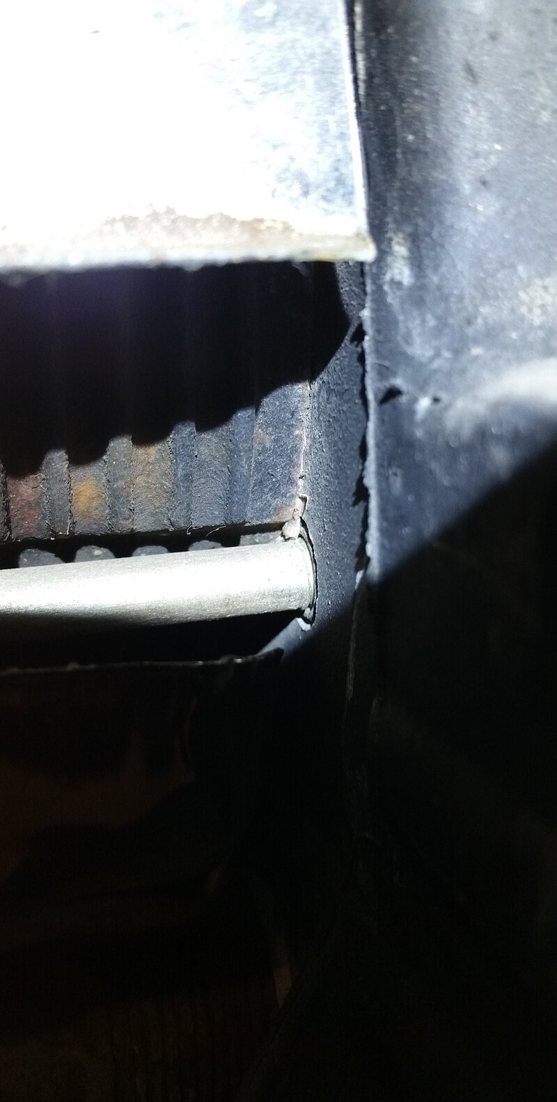

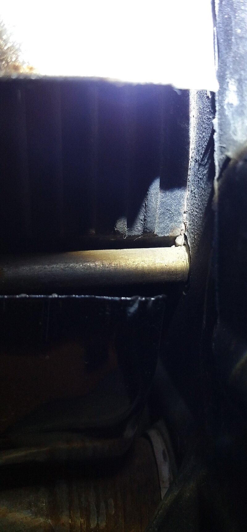

So there is the tin that in the way mostly, right side (1,2) is got the grime, but I looked at the left side (3,4) and 4 was cleaner than 3, plus hard to get back and get the angle I need to see that area.

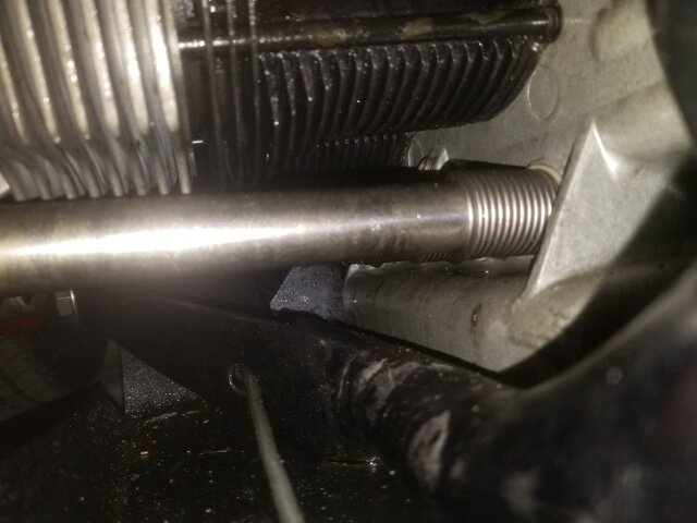

So I did not snap a pic, probably should, but at that section of head enters the case, are they flat surfaces (case & head) or is there a lip on the cylinder that mates with the case ?
I ask because I can not really see a shim, but it does not look like the cylinder mates flat against the case, a fine edge of the cylinder can be seen and I slide a .025 gauge along the case and into that space, .030 would not fit.
I will take the pic, hard for me to see a difference when I do not know what I am really looking for, maybe others will see it.
back in a flash, Let it roar Rex.
Ok well.....that does narrow things down a bit.
No huge shims. Most non stocks do require shims and/or custom machine work.
It does not look cut for 94mm bore. There is additional machine work involved in that.
It does look like the step the cylinder sits on is very small.
Possibly 90.5 to 92 bore cut.
So assuming it is 76 stroke then....
For a no to minimal shim it would have to be extra short rod (not common) or B pin height pistons and a long rod.
This does give me some idea of what it maybe, if one ever had to pull a head off than they could measure the cylinder bore. Eventually with all the data collected one might get real close to figuring it out with out cracking open the case, but still one should wait on buying parts for the rebuild until they know what they have inside the case.
