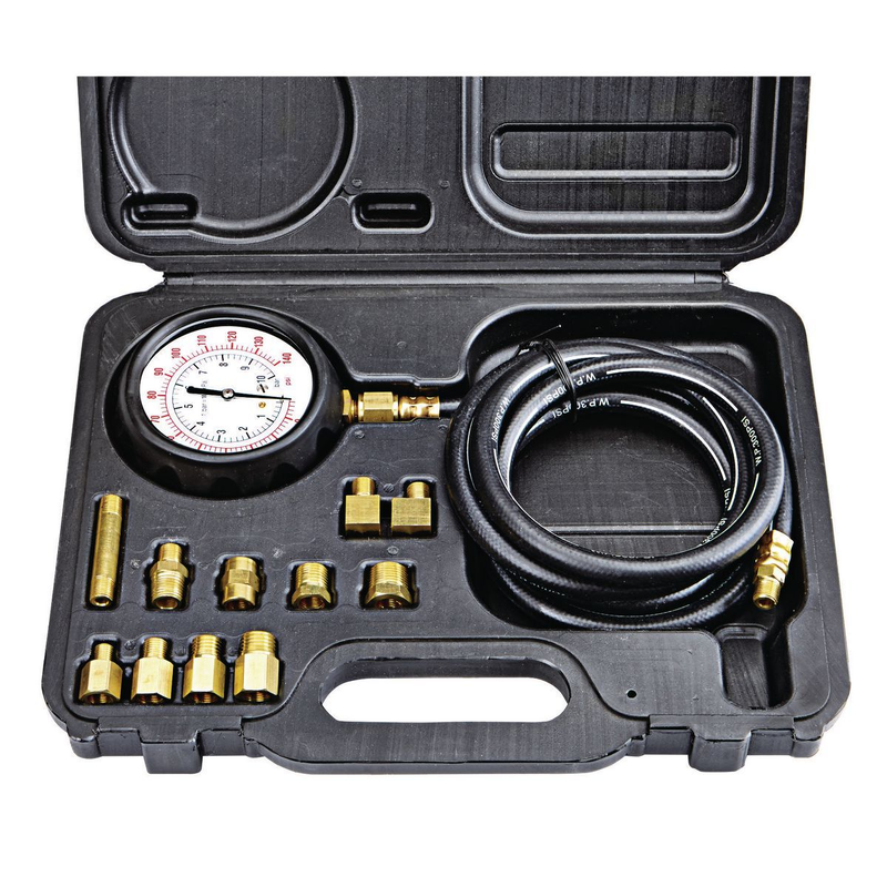

You can build your own oil pressure master gauge with a grease gun hose and a good pressure gauge, or you can get a master gauge kit cheap on Amazon and @ Harbor Freight
