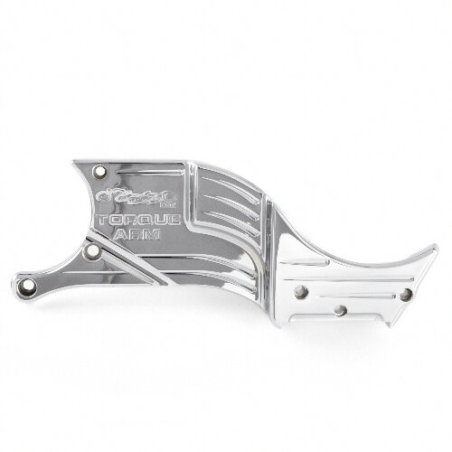

All of the Evo Dyna's must install a Carlini Torque Arm or it will break the inner primary. There is also a lot of frame flex that is unavoidable. Front exhaust pipe will hit the frame down tube when turning or loaded over bumps. Re-routing the exhaust slightly will cure that or maybe a different front pipe.
http://www.carlinidesign.com/Torque-Arms/
