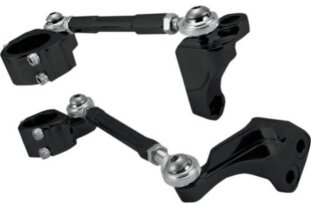

Alloy Art Combi Stabilizer Kit - DC-1
This might help . I too am building a '08 Dyna Street Bob . Am planning adding this after I get everything else set up . About $300 is a lot to spend but if it will help in keeping the swing arm from moving around . Maybe someone else has a suggestion .
Those will help with stabilizing the engine/transmission assembly, which since the swing arm mounts to the transmission helps keep the rear wheel in line with the frame. However, they don't address the changes in loads applied to the swing arm pivot on the transmission case. In a two wheel application, the swing arm pivot axis inclines with the bike when going around a corner. Convert to a trike and when going around a corner the swing arm pivot has a torsional load applied to it since it's trying to lift the inside wheel.
