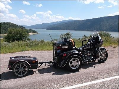

04 Ultra Classic Twin Cam ,Frankenstein Kit, Hyway no problem 2 up
