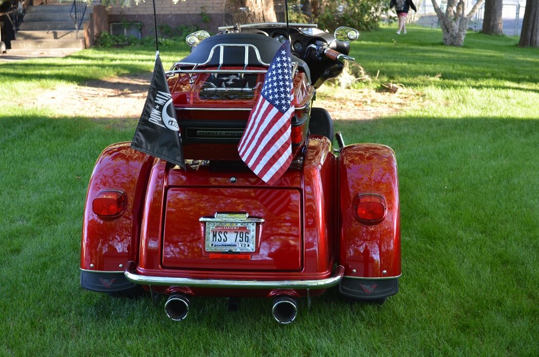

Here's a pic of some 4" rounds-
Certainly looks like there is enough room for 4.5" to fit.
