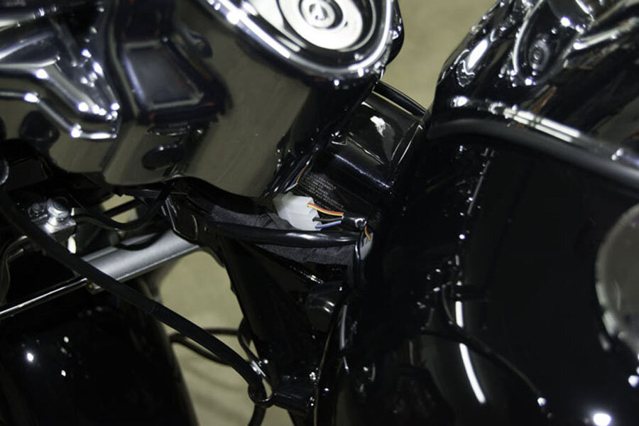

Removed the gas tank. On the left front side of the frame wire trough, there's a white Molex 4-pin female connection with 3 wires out, doubled-back and secured with a black nylon cable strap. Cut the nylon cable strap to release the Molex 4-wire connector that H-D intended to use as auxiliary (passing) lights.
The H-D harness black wire is ground. The red wire w/a yellow tracer is the accessory 12v wire from the 20 amp P&A fuse. There's also a blue wire w/a gray tracer that goes to the right-side handlebar switch, which H-D hasn't released yet.
