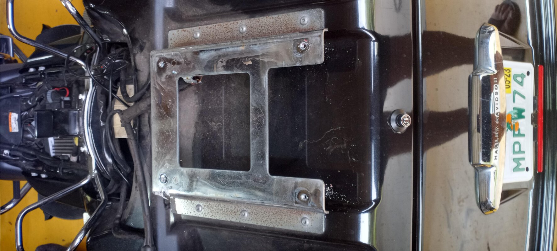

For my next trick I am going to try and move the tour pack back some. DK's kit starts at 2014 but mines a 2013.
Took the pack off and it looks to me like I need to move the bracket back on the body by drilling 6 new holes. Am I thinking that correct?
That's what a friend did on his 2018 TG. Not sure if his bracket was same as yours or how many holes but he did drill new holes in the trike body to move the entire setup back. BTW I do think Kevin/DK has a relo kit for your TG . . . or if not there should be some available if you 'google.'
[/COLOR][/B]That's what a friend did on his 2018 TG. Not sure if his bracket was same as yours or how many holes but he did drill new holes in the trike body to move the entire setup back. BTW I do think Kevin/DK has a relo kit for your TG . . . or if not there should be some available if you 'google.'
I haven't been able to find anything.
I read that I should only have to drill 2 holes but I can't see how that would work here.
It's not that big of a deal now but when we go to WY, MT, Ut and CO my Florida girl will be layering up.
I'd rather move her back than lose my back rest.
Figure as long as I'm putting parts on I can get this done.
