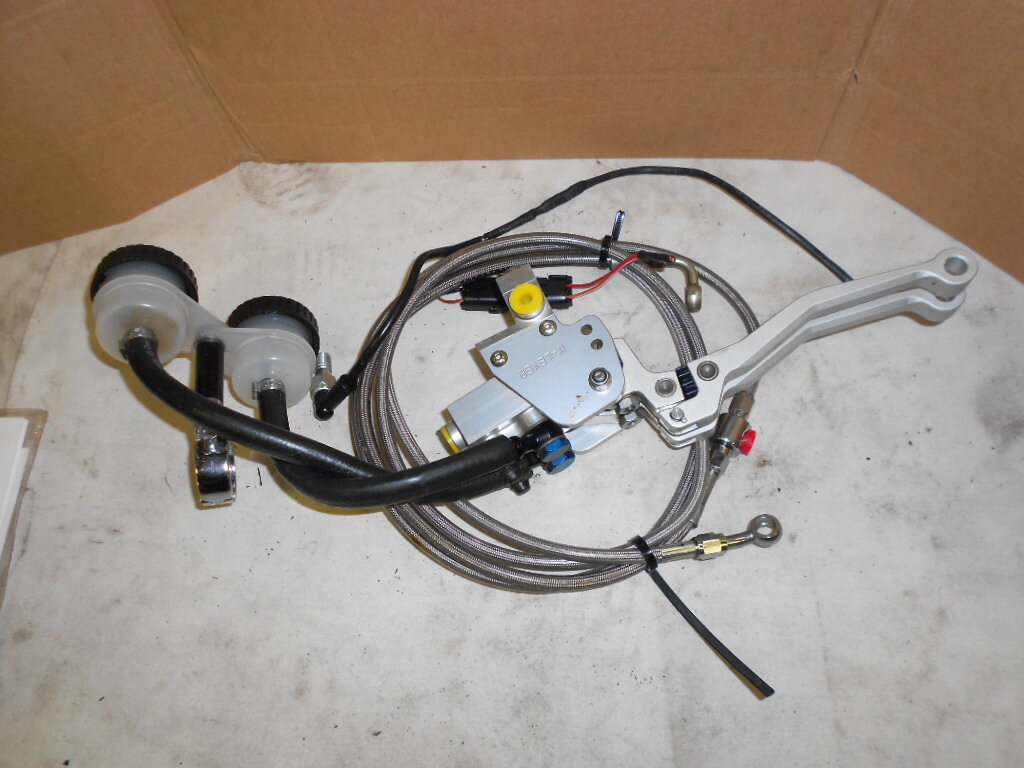

Most expensive way to go is the K-Lever system.
This system is over $2500.00 but has that backup system.
I have a (virtually brand new) K-Lever system for $1,000.00 that was on a showroom demo in 2012.
2011 Tri Glide Black
Thanks for info.will proably try linking together. K Lever is alright except those ugly fluid tanks and no way to hide them.
