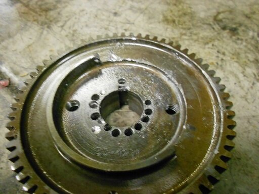

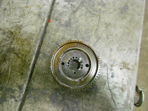

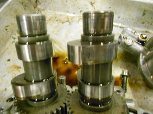

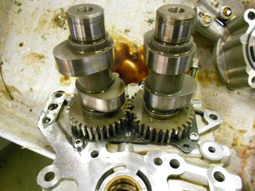

S&S Gear Drive Failure
Everything in the Cam Chest is trashed except for the Cam Thrust Plate and the Pinion Drive Gear that I was able to save. The Cams, both Cam Gears, Cam drive Gear, Oil Pump and Cam Bearings.

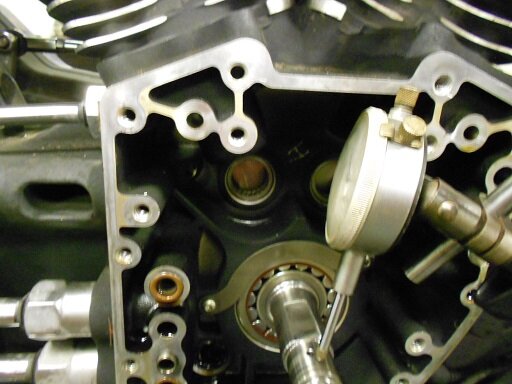

I spoke to Harley-Davidson to find out what would cause this kind of failure. They told me that the main cause was too much Pinion Runout. S&S says if Pinion Runout exceeds .001 you cannot expect it to perform properly.DSCN1535.JPG
The Pinion Runout in this engine is .003 so a Gear Drive Cam setup is not advisable.

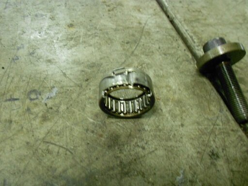

CAUSE OF FAILURE:
During the disassembly I found the Rear Inner Cam Bearing had been installed improperly. Whether the Cam Bearing, Excessive Pinion Shaft Runout or a combination of both, the Inner Cam Gear lost a tooth and momentarily ceased the Cams and the Outer Drive Gear sheared the key and spun the gear 90 Degrees throwing Valve Timing Off and Leaving Exhaust Valves Open too long striking the tops of the Pistons.
Also during inspection I found the Intake Ramp on the Rear Cam for the rear Cylinder showed unusual wear and was subject to failure in the near future. This happened to be where the bad bearing was.
The Key sheared and allowed the gear to move 90 degrees and ceases the broken key to the shaft. The holes drilled into the cam gear were done to reduce the stress on the shaft so that I could use a puller to get it apart. Once removed I could then access the 3 bolts beneath the gear to remove the torque plate.
