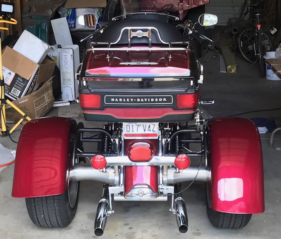

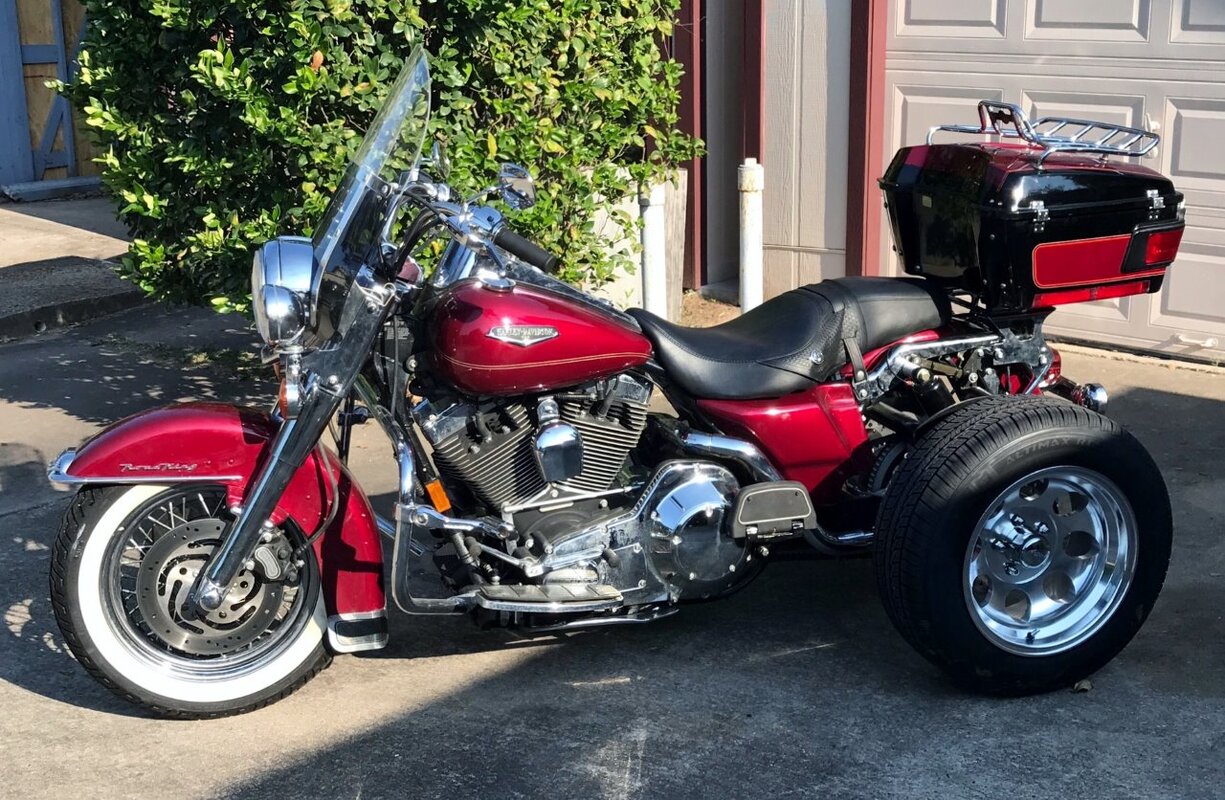

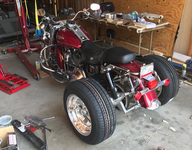

The sun is back out, the trike is done, and all is well. Below are a couple of better pictures, but I wanted add a few comments about the guys at Frankenstein Trikes.
I am very happy with the trike kit and had a lot of fun putting it together. I've had two people at work ask me if I traded the Harley in on a new trike. That speaks a lot about how well the kit goes together.
Throughout the process, the folks at Frankenstein have been extremely responsive. They shipped lightening fast and responded to questions rapidly. I had one damaged part, emailed the night I saw it was damaged, and a new one shipped before lunchtime the next day. Overall, the best service I've had from any company in a long time.
The trike rides great.
Hope to see y'all on the road some day.

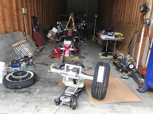

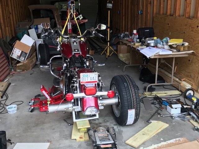

I've been debating for the last 3 months, but I finally took the plunge and ordered my trike kit for my 2004 Road King Classic.
I ordered the Frankenstein Premium Combo kit (trike kit, exhaust, and triple tree) with dual brakes and the parking brake kit.
I'll take pictures and post them here as I work through the conversion.

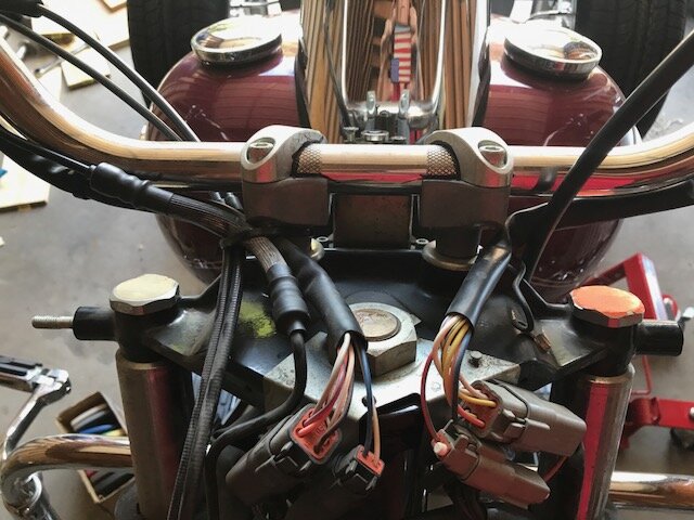

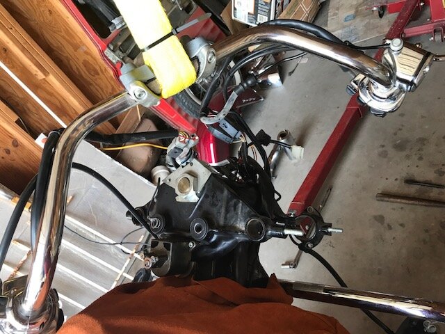

As Ted mentioned, the stem nut needs to be tighter than on a 2 wheeler. It is a star nut under the large nut shown in the first picture of the #13 post in this thread. This nut holds the triple tree on. When it is tighter, it puts more preload on the bearings.
When you convert a bike to a trike, most people change the triple tree to make the trike steer easier. There is a discussion on rake and trail on the Frankenstein website.
http://www.frankensteintrikes.com/components_tripletrees_main.html
You should check to see if your triple tree is stock or if it has been changed. The photos on post #13 show the stock tree on my bike (black) and the new one I installed (silver). My new triple tree came with my kit, but others also make/sell good trees.
