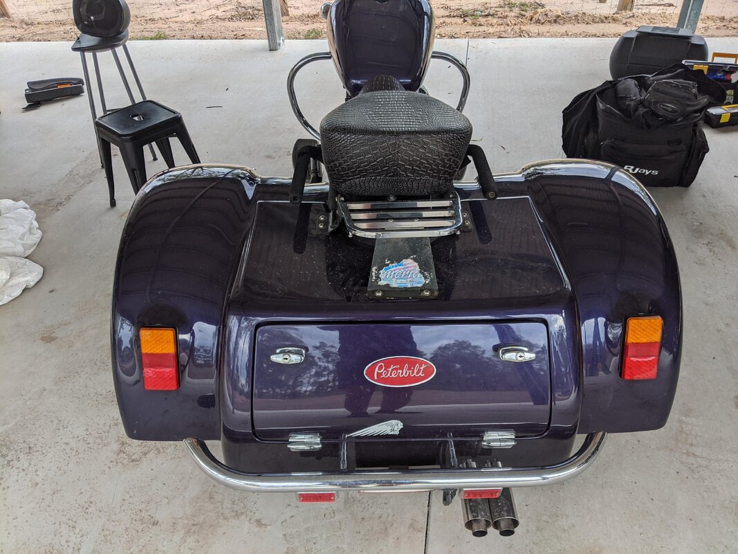

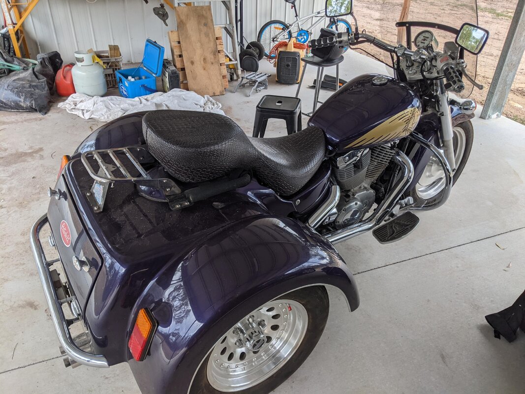

I have a MT conversion Honda spirit 2004 - It has coiled struts with separate airbags. My issue is that the trike is not riding evenly and tends to lean to the left. When inflating the bags - it tends to rise quicker on the right side and only evens out when fully inflated. There are no leaks. Any suggestion gratefully received.
Check all attachments from motorcycle frame to trike frame and all bushings and brackets on all suspension parts. Good luck with your search. :wave4:
