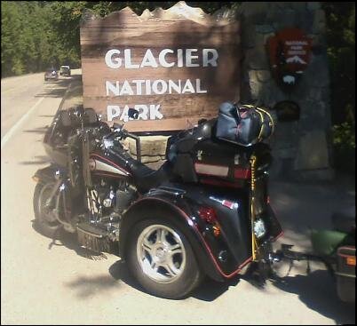

I dont think any trike manufactures make a longer wheel base kit these days. The double belt setup was more troublesome than it was worth.
As far as installing a Independent rear system, the only one I know of for your year bike is DFT. I have a buddy who has a DFT on his 1992 FLHTC. He bought the trike kit without the body and installed his own body.
If I had a choice between a solid axle trike or no trike,I would go with the solid axle and never look back.
Champion Trike offers a solid axle trike conversion for your 90 and their stuff is very good quality.

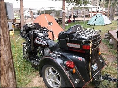

I have the champion straight axle kit on my 1989 fltcu tour glide ultra and I like it just fine. Built it myself.
I believe Frankenstein has one for that year also?
Bought a raked triple tree from Bazooka, handles great.
The ride may be a little rough in town but it's built for the highway and it smooth's right out on the road, corners like it's on rails.
My buddies tri-glide cant compare in handling.
