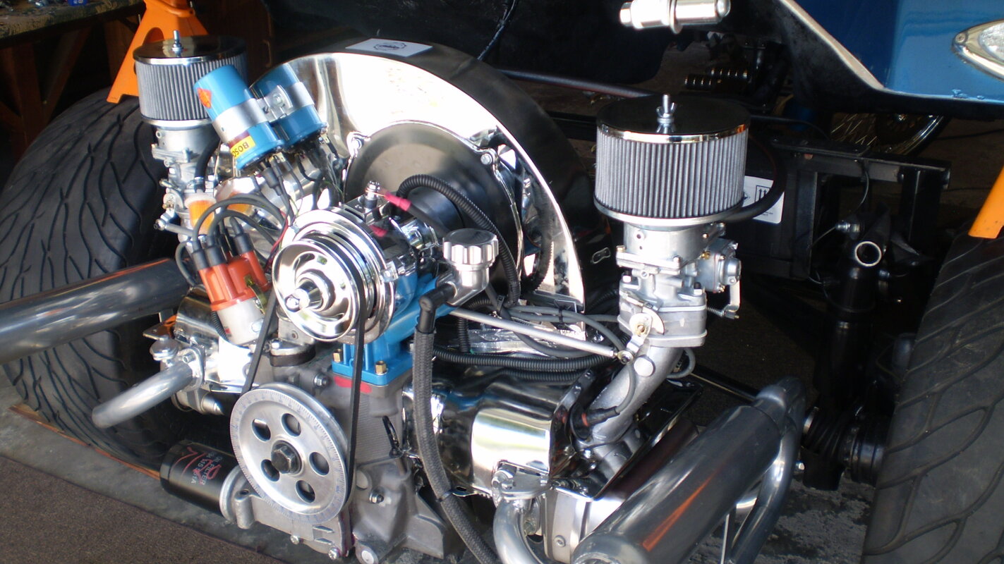

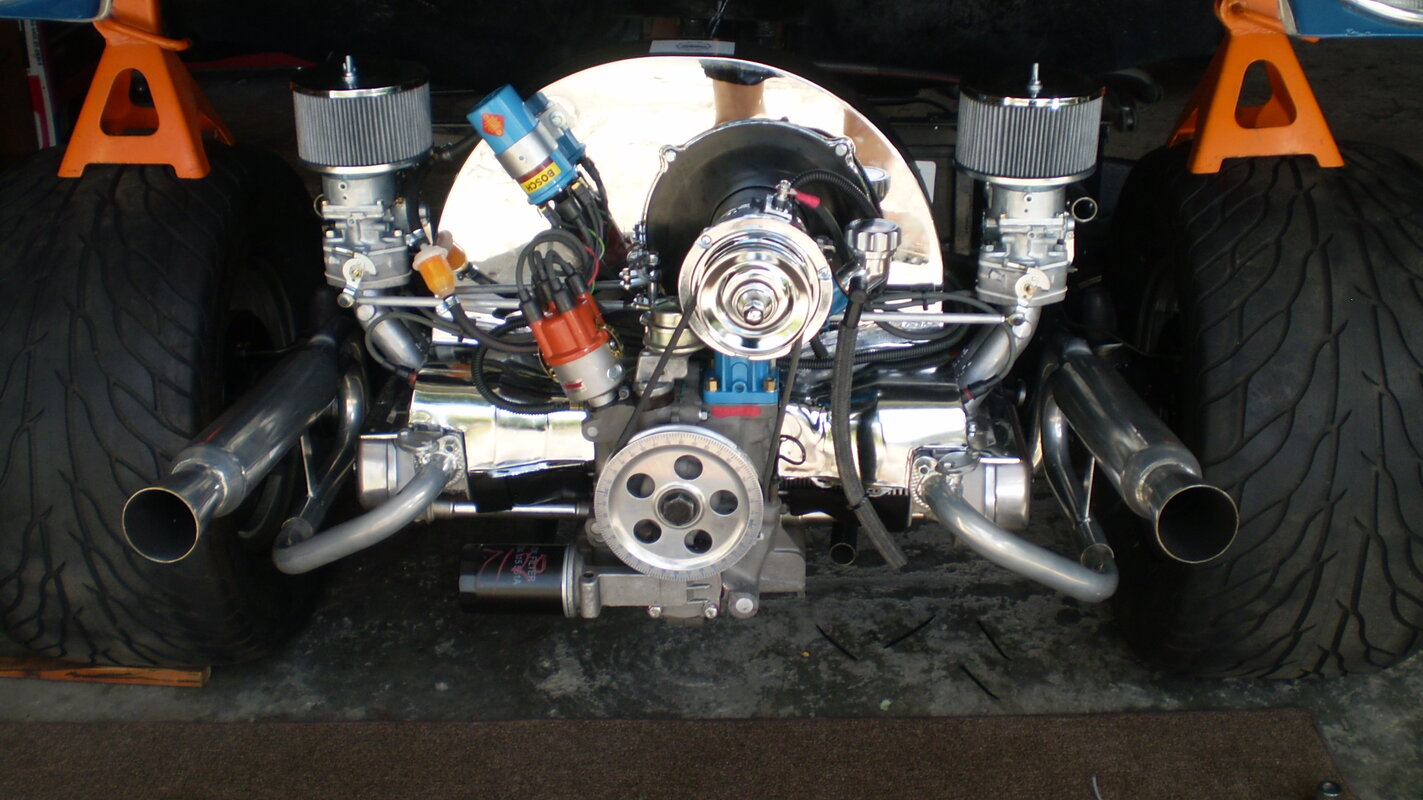

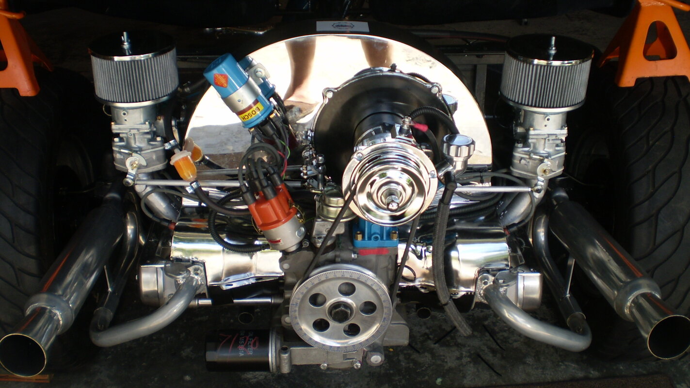

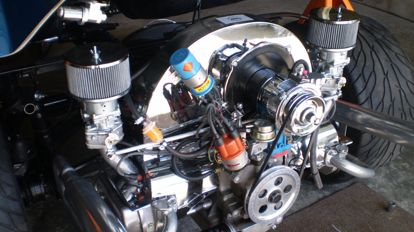

1776 installed. Ready to Ride!
Sharp looking Dave!!!!!!!! :clapping:
However, a 1776 is NOT a stroker engine. LOL. Its a stock 69mm stroke with over size 90.5mm bore pistons and cylinders. :p
Stock 1600 cylinders are 85.5mm bore.
She should get up on her back wheels pretty easy, especially with the weight of the fuel tank being mounted behind the engineThumbUp
If you already said earlier, sorry for asking:Who did the engine build?
Very successful ride this afternoon! What a blast! Very controllable power and I am a big boy so I counter weight the trike nicely. ThumbUp
Great rebuild for an 8 week project. Thanks for all the help guys!
