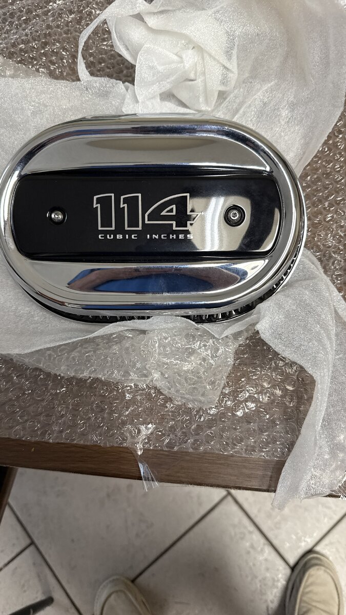

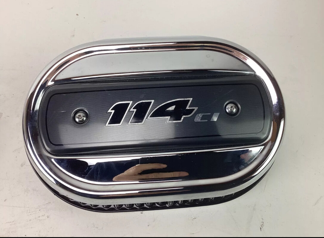

Looking to buy a good used 114 ventilator breather for the trike and was wondering if I had the get a fuel manager too. I’ve been getting back and forth answers of yes and no. So looking for someone that has done it or really knows the right answer. TIAIMG_7562.jpeg

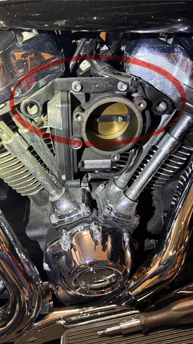

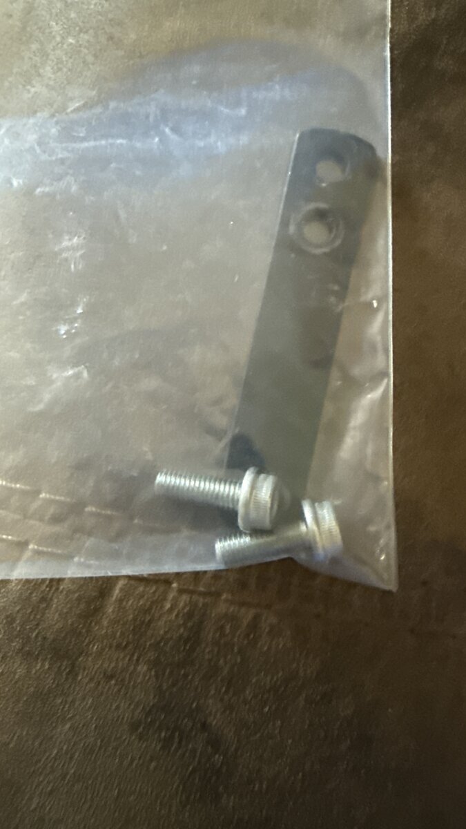

Also did you take this bracket off or keep it on?
Has been 8 months don’t remember but I will check
Sounds like vacuum leak
Recheck your work if you don’t find anything put stock back on and see if it stops
Directions say to REMOVE bracket, did you?
May be bracket you asked about earlier.

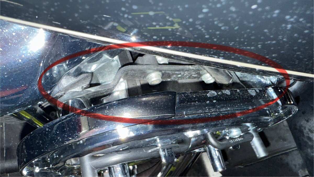

No bracket still there. That’s what I was trying to figure out if I needed to or not. This is the way it’s set up now. Also the breather I have is off a 114 it’s not the se ventilator.IMG_7743.jpeg
No bracket still there. That’s what I was trying to figure out if I needed to or not. This is the way it’s set up now. Also the breather I have is off a 114 it’s not the se ventilator.View attachment 132419
It is a ventilator. That's what comes on Specials. It may be your problem. It spaces it out from the throttle body? Seal at TB? May be where leak is. It's plastic be careful when tightening the 3 screws first then breather bolts.

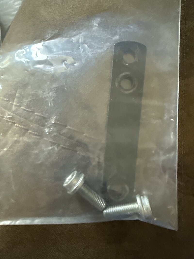

Ok I took off breather and took off the bracket that I have in the picture. And added the bracket that came with the breather (small and it only holds the wire that was attached to the other bracket) and reinstalled everything again. Now to be able to get out tomorrow and try it out.IMG_7667.jpegIMG_7655.jpeg
No where in the directions is there a bracket to be used and is not in the parts list.
I hope there is no damage to the throttle body.

Well the big bracket was behind the original breather. I just wasn’t sure if I needed to remove it before installing the oval 114 OEM Breather. I don’t have any friends that have that breather on their bikes to look at. So took it off last night and put the one that came with it to hold the wire in the back. Couldn’t Wait last night and took for a short ride and no popping for now.
Good! Keep me posted!
Well everything is great so far. I took that big bracket off and replaced it with the smaller one that came with the ventilator in its place. No popping or anything now. Thanks for all the help.

That bracket indeed requires removal.
Here’s the link to full instructions on the ventilator air cleaner kit for 17-newer M8 Trikes:

The ventilator breather I had was off a 114 motor not the HD aftermarket one. So I was trying to figure out how it was installed on the the street glide special. But it’s all good now. Thanks
