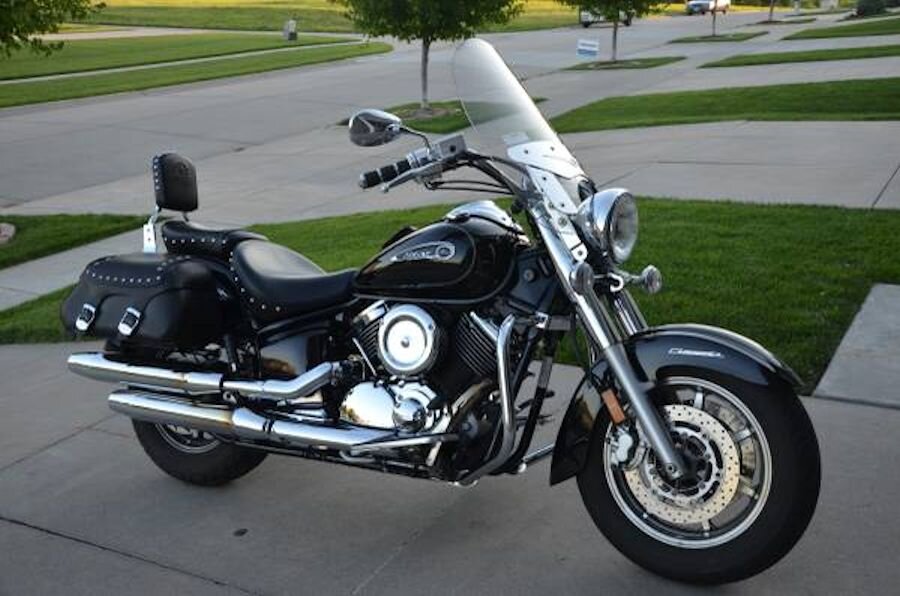

Hello,
I have had my bike since new -ish, I'm the second owner, but purchased it with just over 100 miles on it. Think it was a little to intimidating for original owner.
So, Now I'm up to 6969 mile on it, And have decided I want a Trike.

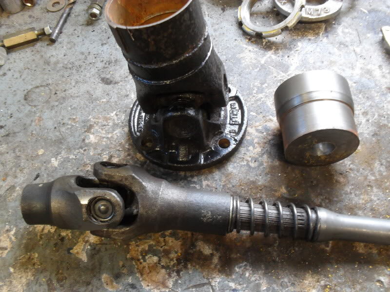

With the research, and general information I was able to find using my Google Fu, I found out that the Tri-Wing kits require you to cut your drive shaft, weld it inside of this coupler they send you, and pretty much it.
If they would have sent me that picture, I may have done it. But they refused to.
Also they use some old, used ford axle that they cut up and fab into a "kit" with drum brakes on it...
This really "killed it", for me.

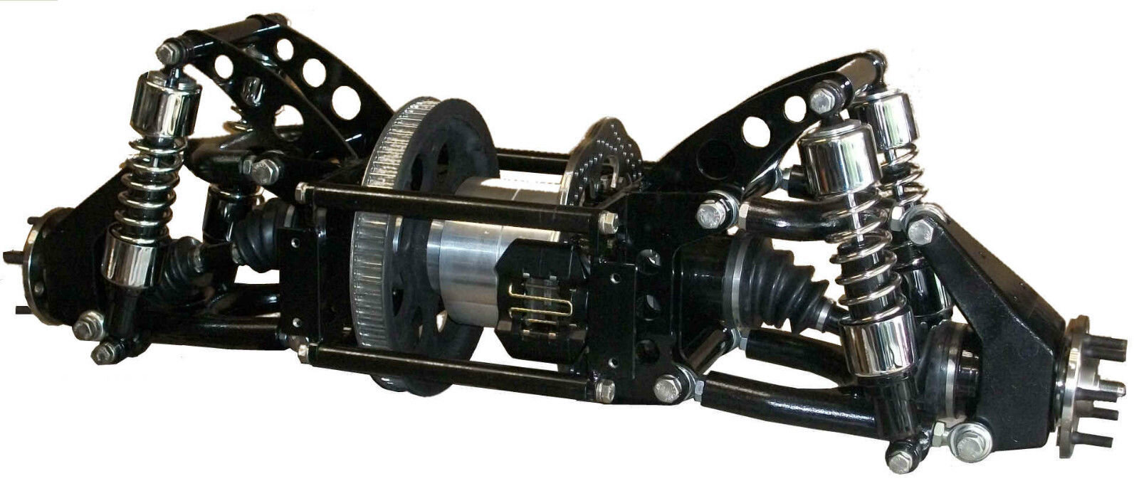

So, I found Tom, at Art in motion, provided my bike info, what I was looking for...
Next day I had an email with the quoted price, parts list, and links to the site - WITH pictures of all the parts! LoL.
http://www.artinmotionllc.net/motorcycle-trike-conversion-kit-with-trike-body-shaft-drive-metric/
Found it uses an American Trike [now Extreme Trike] kit.
I know this one shows a pulley for belt on it - the shaft drive one was too small.

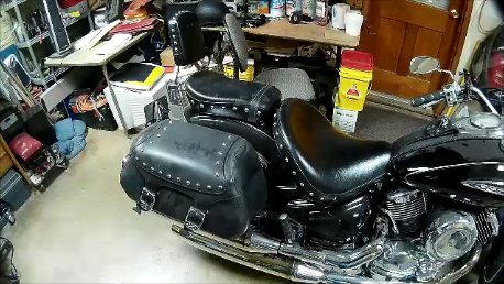

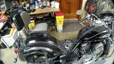

Pics of the tear down:
Pic from last Fall2015

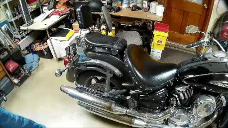

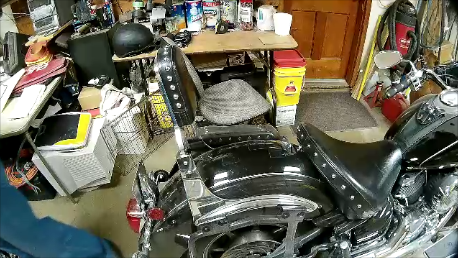

Start to take off the saddle bags and seats.

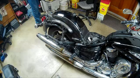

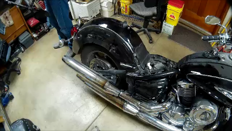

View attachment 34915 Starting to remove the stock mufflers.
Pic of it from left side.
Start removal of the bar for the saddle bags, the Rear disk brake caliper.
Make sure to hang disk caliper by a wire or other such, dont want to just hang it by it's hose...

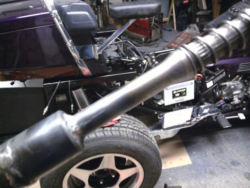

Checking the alignment for the drive shaft
"Test" fitting to the bike / Trike.
Checking side to side and centering.
looks good, so far.
Now, I'm just waiting on wheels, then can mount the body and trim to fit.

Okay, MUCH progress!
Started Mocking up the body, mounting and fitting.
Started to run into an issue - Of where the exhaust would mount, exit - Or even Look.
So, we stopped, mounted up the Exhaust and - Test ride - First ONE!!!!:DThumbUp:cool:
^^ Had, an ongoing issue with the brake lines - the 2psi residual valve, fittings, hose kept leaking....
Ended up having to just run all one piece new braided line right to the master cylinder.
That Cobra Drag Star shotgun pipes not only look good :cool:
But sound AMAZING! - Have to go to my build video 18 at about 29 seconds in to hear it.
Using the Flex pipe - as too much movement between the bike frame and the IRS to use solid pipe.
Doesnt look as bad as I thought it would - and most of it will be covered by the body, then crome heat shields...
Closer look at the "studs" I added to the air filter.
As the Hyper charger I was wanting, would cause more issue then what it was worth..
Had to dress it up...just a little.
Back to the body now that we have the exhaust figured out.
^ 1st cut, yes, still need to round out the corners - and lots of trimming to go -
All leveled up, looks right.
Will need to wait till next weekend to get it out side, to have more room to walk around it. Make sure everthing is exactly where it needs to be.
Then I can make the Final trimmings. and Drill the mounting holes.
Some more pics - realized I didn't show the tank, seats and fender on it.
As I said, I did go for a "test" ride. I went before I started trimming the body, right after I mounted the exhaust.
