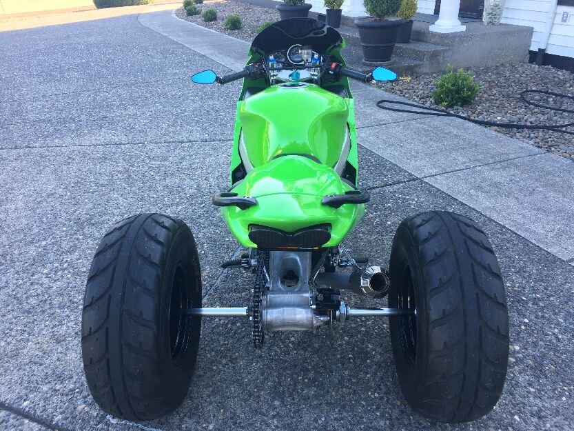

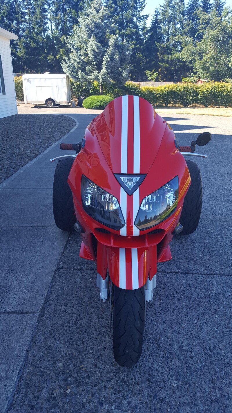

How can we get more information on this bike more picture the bill procedure what did you use for a rear end.:clapping:
I use a 2005 Yamaha yfz 450 quad rear end. Very simple design and extremely strong. Its a pretty straight forward conversion. Hardest part is making the bushings and spacers. Linkage arms have to be lengthened a bit also.
