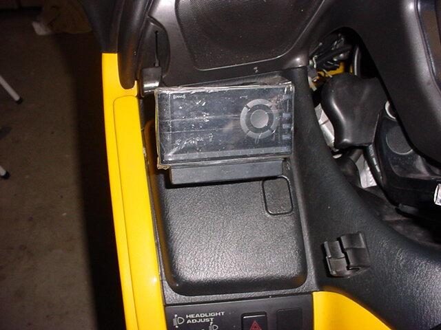

You don't say what year your bike is. But in my 2010 GW in the left side pocket. Take out the tray and the Auxiliary radio hook up for the radio is in the harness under the pocket cover. I also connected the holder to the pockets cover. Not the best but only place I could find that doesn't interfere with anything.It was a simple plug N play for my XM head.
The picture you can see I wrapped the head up to take rains a bit better as its not water proof without a cover.

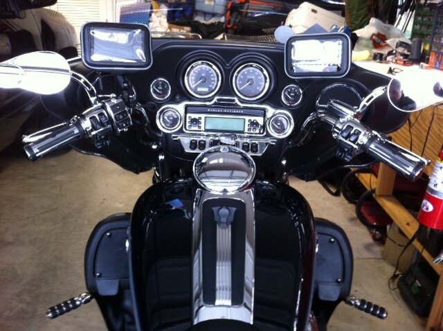

Used Ram Mounts for my GPS and XM Radio. Both powered from the Accessory switch. XM antenna is on the Tourpak. Both covered with a rain covers.
