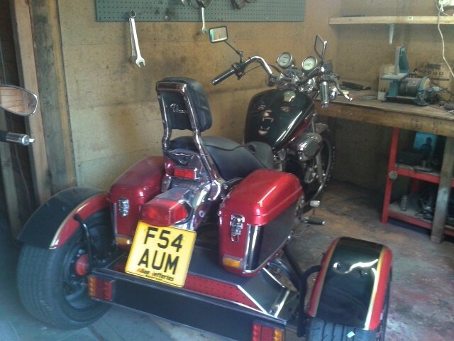

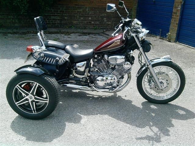

Hi to every one i have not been hear for a few years last time i was hear i did an how to on an xv 1100 well after just recovering from an opperation for lung cancer i need to focus on somthing else when in recovery i bought an xj 750 and now its time to trike it it will not be an how to this time i will just get on with it im not sure how to post pictures any more so will have a go and show some of the trikes i have converted since i was hear last

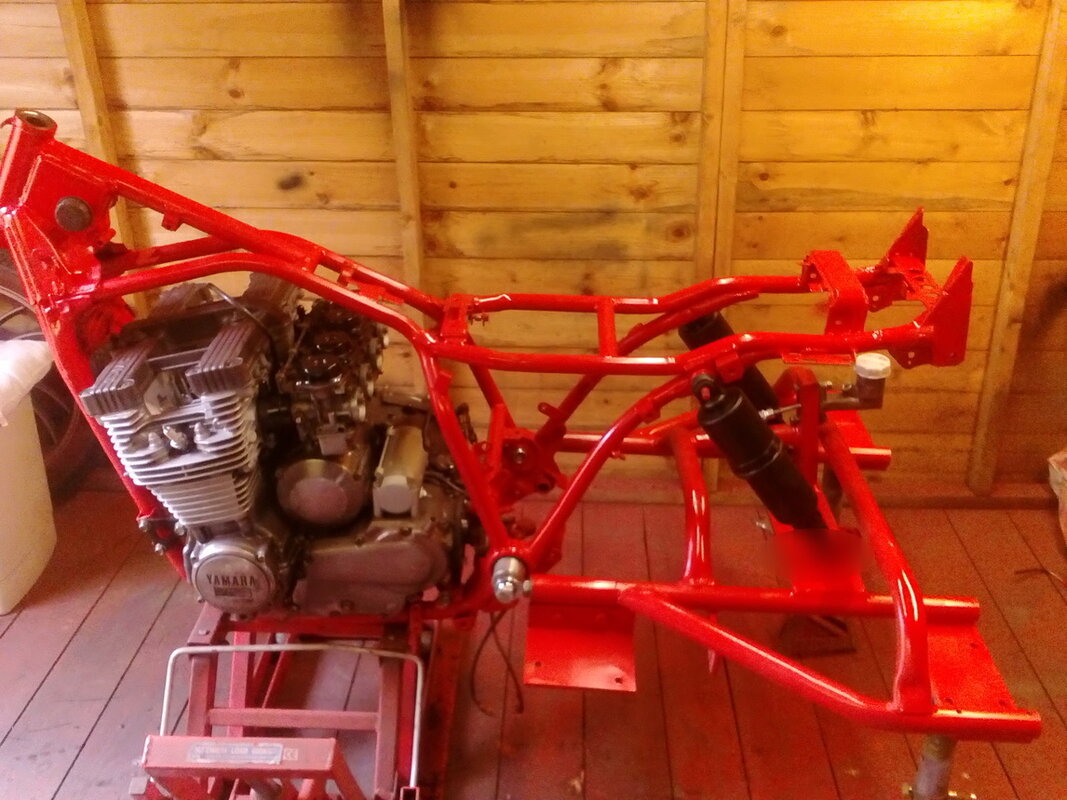

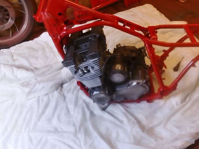

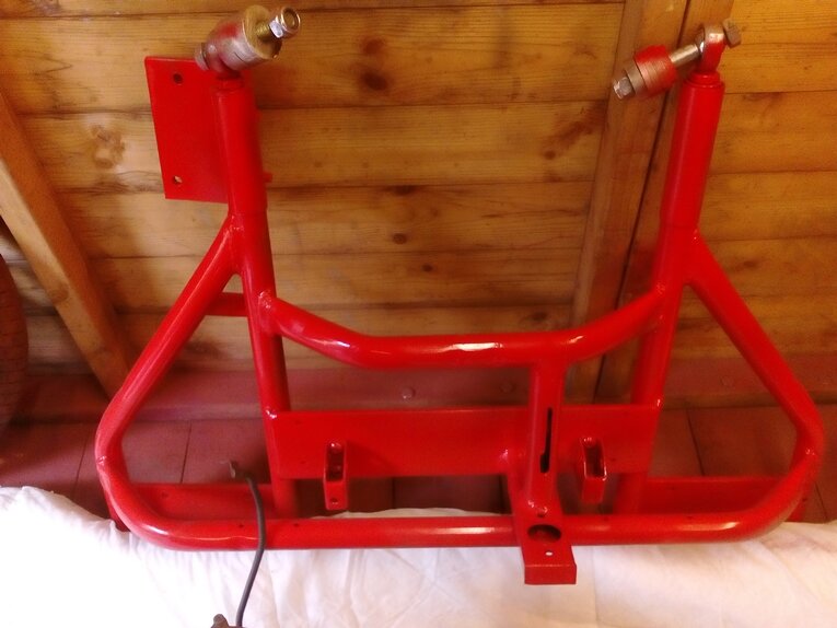

I am going to start with the frame of the bike and have repainted it in red and not the original black I have also cleaned and re painted the engine I will be using my original swingarm much the same as I used on the xv1100 last time I was hear pleas don't forget this is shed stuff

Nice work, Mate!
Are you using the same rear axle assembly on all of your trikes and what make is it, if you care to share that info...?
Hi there the axle i use is a reliant axle and have used it on every conversion i have done its light so wont ware your gear box out, i alway press out the tubes then press a tube in side of the original tubes to beef it up a little then press s/s over the outer of the original tube this is after striping the axle of all its original brackets the ratio is 3.23 they come in 3 different ratios the other two being 3.54 and a 2.78

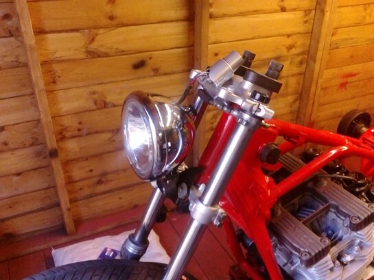

Good polish and yokes cleaned and re painted the front end is back on
