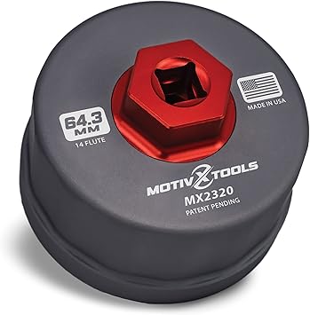

This works good but spendy.
[FONT=&quot]
[/FONT]
[FONT=&quot][h=3]Amazon.com: Motivx Tools Oil Filter Wrench for Toyota Camry, Tundra, Tacoma, 4Runner, RAV4 and More - 64mm 14 Flute Precision CNC Machined Aluminum Oil Filter Removal Tool : Automotive[/h]Buy Motivx Tools Oil Filter Wrench for Toyota Camry, Tundra, Tacoma, 4Runner, RAV4 and More - 64mm 14 Flute Precision CNC Machined Aluminum Oil Filter Removal Tool: Oil Filter Wrenches - Amazon.com ✓ FREE DELIVERY possible on eligible purchases

Found one… $17.. and reversible. Open the jaws with your fingers and turn the cam. Cool. Thanks guys.
