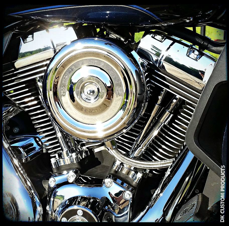

I had the same results when I installed the discrete breather on My TriGlide '15 with a Fuel Moto Pro billit stage 1 air cleaner with stock Rushmore cover.I also installed a DK 1-1/2" tank lift at the same time. That may have helped some too.
