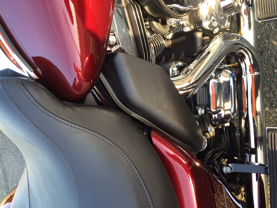

Greetings to all enthusiasts!
I love my trike... Freewheeler, love the handling, love the ride.
It is so sad that these awesome machines run so hot!
Wife and I ride on weekends, of course its deep into the summer, and traffic is miserable in my area of the woods... so we stand in traffic for a while. Then it is so much heat coming from the pipes... that it becomes unbearable, and Momma, says Joe you gotta do something.
I purchased a set of mid air deflectors... kind of works, still hot..
Why did you do that Harley Davidson to such a wonderful machine...
most of your heat is coming from the header. you can get a de-catted header which will lower your heat a lot. get a tuner and you can richen your fuel mixture. vance and hines makes a nice header but they are not cheap.im going to do mine this winter
There is a ton of info on the forum about making an air cooled V-twing run cooler. The reason they feel hotter is due to EPA regulations. MoCo has to run them lean to get them to pass EPA. That makes them put off more heat.
I de-catted my stock head pipes and added Nightrider FL-Vied-10 fuel enrichers (set at 62.5%) to my 2014 TriGlide (22k miles now) and it made a world of difference. I still run stock mufflers and air filter.

This was the cheapest solution .... and it worked. If you plan on doing cams or other major mods then invest in a full blown tuner.
My passenger never complains about the heat now!!!! Life is great.
Bob :D
I gutted my cat, installed a stage 1 breather, screaming eagle tuner, wrapped the pipes, dyno tuned. It all made a big difference.
Gutting the cat and installing the stage 1 breather was the best bang for the buck.
There is a guy on craigslist here in Sarasota,fl. (it may be on the Tampa list , getting old and forgot) but anyway he has a new full set of Vance and Hines Power duels for 300.00. I already have my header so thought I would pass this on to you folks.:)ThumbUp
if I only de-cat, is a tune required ?
If you are going to run the stock mufflers in my opinion no retune is required,and here is my reasoning.If you look at the position of the 02 sensors they are in front of the cat there for any changes in exhaust flow would not have any effect on the sensors.I ran a gutted pipe with Screaming Eagle 4 inch street cannon mufflers with stock tune,with out any issues in running or performance.But if you talk to ten different people you will get ten different answers.If you talk to a good tech they will tell you that the ECM has a very limited ability to adjust so as long as you don't change the air intake you will be good to go.
