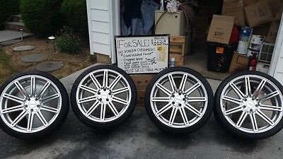

image.jpgLet's 1st ask why? Do you just want bigger showy rims? Do you want larger dia tires?
you can put 20" on it if you want to run 33 sidewalks (looks like rubber bands on rims and rides like a buckboard. )
what is on it now? 13"? I am confused!!!
OK the first thing you need is the specs on your rims so you know the initial offset. From there look up the specs on your existing tire. I use Tire Rack's website to get that info. Do NOT order the tires and rims from them as they will not sell them to motorcycle owners! Once you have the diameter and width then compare them to what you want to switch to. The larger the tire width, the more positive offset you want.
You need to look under the trike to see just how much room you have, and you also have to consider the shock travel. I wouldn't increase your diameter more than an inch unless you know the exact clearance of the shock travel at bottom vs the tire.
If your speedometer is driven off the rear differential then you will need to put a speedometer healer on to correct the error or use your GPS all the time as a speedometer...
