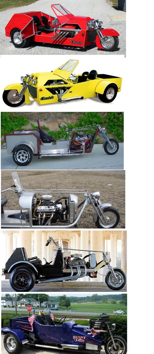

I have been doing some research on Rake, Trail and Offset
I understand Trail is the most important but I would like a certain look in the rake.
I don't know whose trikes these are but I do like their rakes.
Any idea what rakes they are?
Just print out the straight-on side view and use a protractor to determine the rake angle. You will be able to determine the trail this way also. Not 100% but close enough for Government work.
will try that tonight

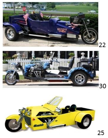

I ran out of ink so I could only do these 3
I think I did something wrong because the rakes do not look right to me
Just by eye, if the top and bottom trikes were broadside to us,
like the middle one is, the angles would almost be the same.
the rake angles look to be about right for a front engine trike.
just my .02
Yep. Pix need to be straight on sideways views not 3/4ish angles as seen in top and bottom pix. I'm thinking about 30 degrees also. Just because a trike has been built with more or less neck angle doesn't mean that it is more or less rideable. One thing for sure, more neck angle equals more stresses on the frame at the neck area.

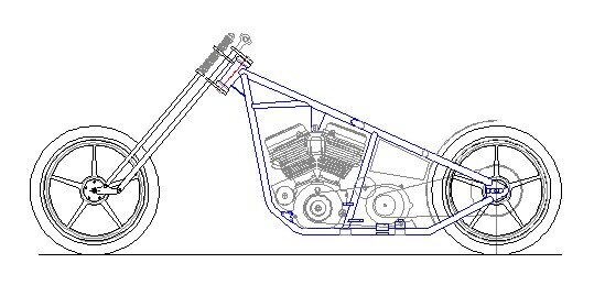

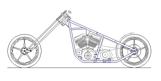

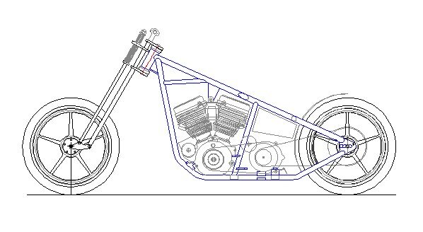

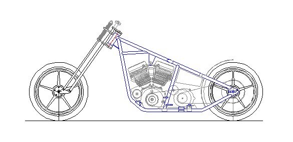

with the 45 deg.....the lower ball or roller neck bearing will have most of the engine wt. on one or two rollers or balls...same with the upper bearing.....not good! The rake closer to 30 would better imho. However, rear engine trike......not an issue.

What is those trikes rake, I would look at 40 degree's, want longer forks go with more rake in the neck, want short tight forks and smaller front tire, go 35 to 37 degrees. Again everyone is just offering opinions, you get to choose what sounds good.
